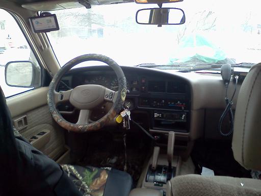

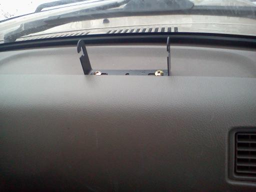

hey im no pro but heres my 2 cent: this is pics of mine in my 94 t4r. i had to make heat shields to put over the defrost vent though is only problem. dont buy a walmart magnetic mount antenna. its not worth s.... i have one and it sucks. get a firestick from trdparts4u.com. my buddy has one. hope it helps! sorry dont have better pics

Thanks Jimmy. Yea i know all about those walmart antennas lol. I'm in need of a new antenna so I'll have to check those out. What kind of reception do they get? What kind of CB do you have? I have the Standard Cobra 29. Now do you have yours hardwired in or do you just use your cigarette lighter? Thanks again
i dont get great reception, but then again i made my own antenna haha. i have a cobra 19 ultra 3. i picked it up at radio shack on sale for 35 bucks. i have my wires run under the dash to the fuse box by the drivers feet and spliced it so the pos end is wrapped around an auxiliary fuse (i used the radio fuse) and the ground screwed into to the inside of the door jam where i scrapped away the paint in a little place. id like to upgrade my cb as well as my antenna soon but $$ tight
