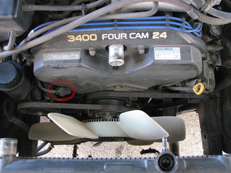

On the P0340, that's definitely something they could have screwed up doing the TB. There is a connector through the upper TB cover low down on the left looking at the engine from the front. Here is the sensor itself, pointing at the pulley right where the white timing mark is (see arrow):
Check the connector on the cover. If that that's not it, take it back to the mechanic who did the TB. If it runs OK, you can drive it. (JD90--it's a sensor issue, not the actual position of the camshaft itself.)

Ok looks like maybe I take the cover off to see/get to that connection? Can't quite tell
The plug is on the outside. No need to take the cover off.

Ok loks like you guys are on to something. Took a look and sure enough no connection. Can't tell but maybe this might be the connector (in second pic to the right of my thumb). Also found the wire that goes into the connector I believe, just hanging loose (also in scond pic - why the heck is this just hanging loose!) Could this throw all of the afore mentioned codes?

Well, for sure it's the P0340. That's exactly the kind of thing I thought you would find. It looks like plug and connector got ripped off. Is the black thing by the thumb connected to a wire that goes behind the cover? Are both halves there? By rights, it's your mechanic's problem. Or, you might want to take the cover off and see where the sensor's wires lead and if the other half of the connector is loose inside if it is not outside. (Kudos to kball for that pic, I was looking for one like that and couldn't find it.)
