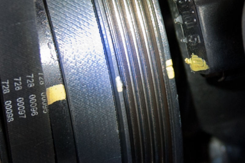

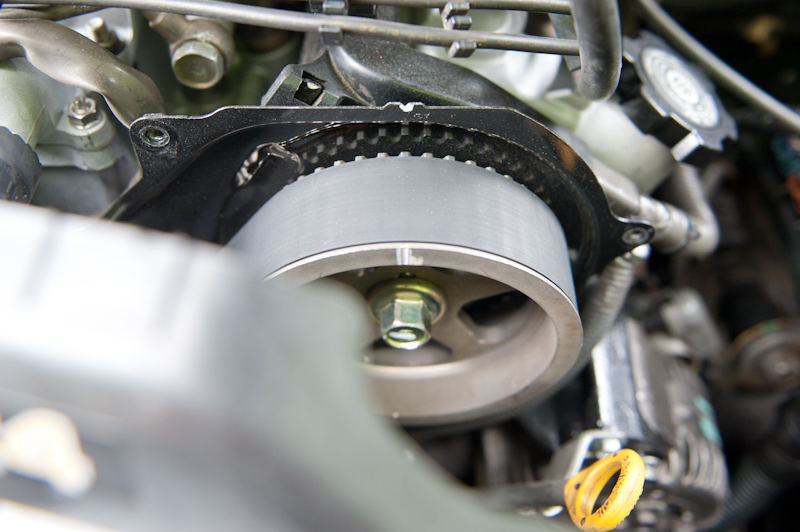

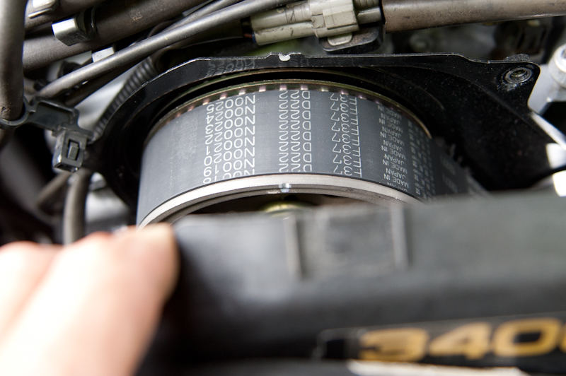

it will be the best if I show you what I'm seeing. I've pulled it apart again and took some pics.
See attached. Does it look ok?

Just to be thorough, when you looked at the cams did you make sure the crank pulley was lined up. The crank pulley should be lined up with the front cover and the cam pulleys should be lined up with the notches on the timing cover behind the pulleys. All three need to be lined up properly. The code and the issues above 4k really make me think the timing is off.
I see your quals and I ask this in the spirit of wanting learn from an expert. The FSM says the DTC set condition for P0340 is "no signal" from the camshaft position sensor either at crank or above 600 rpm. Does 'no signal' equate to a signal a few degrees off but presumably steady that a poor TB alignment would cause?
It seemed to me that a 'no signal' condition would have to be from tooth to sensor to wires to ECM, but would not be due to advanced or re****ed valve timing. I'd appreciate an explanation. Thanks.
And I certainly agree with your point about checking the crankshaft sprocket against the camshaft.
