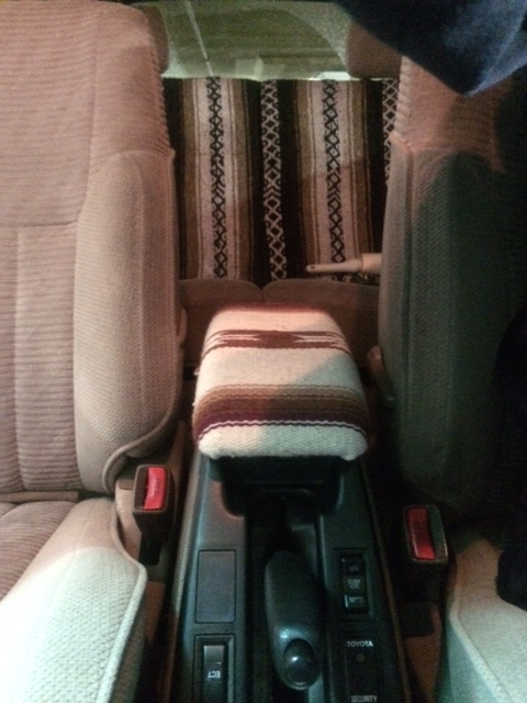

I recovered mine but left the original foam. I used contact cement to bond the fabric to the original foam, then screwed the cover back together. It was super simple.

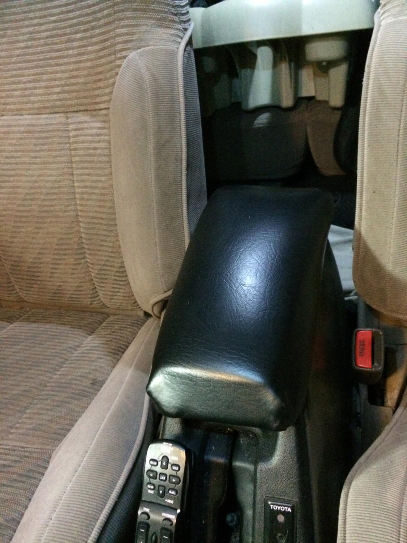

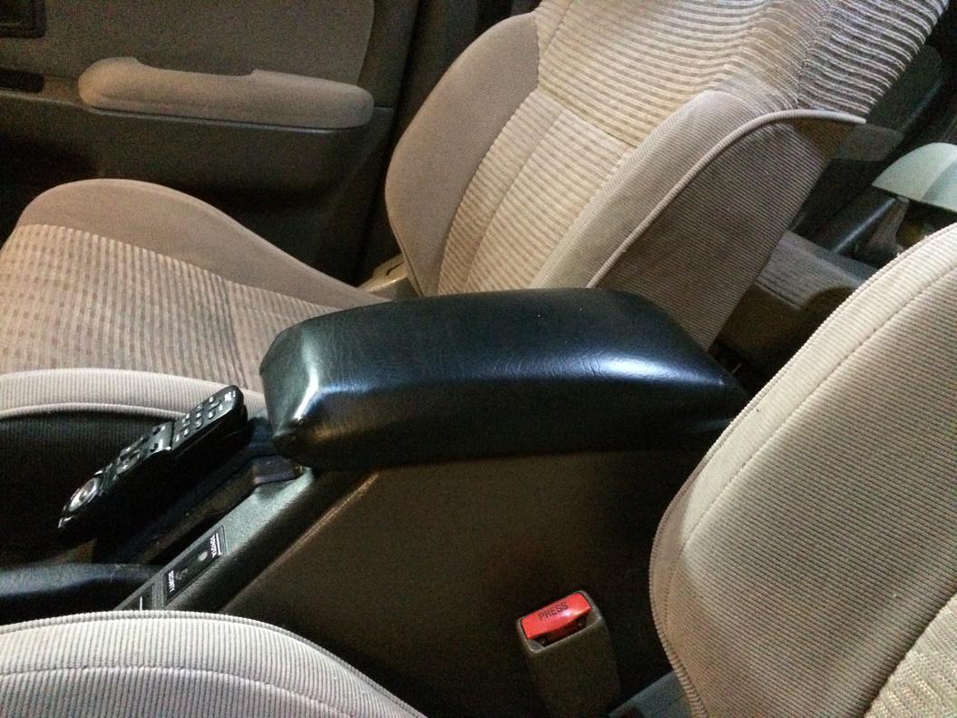

I went to Hobby Lobby and got a thick piece of foam and a piece of vinyl for about $6. They only had black. Cut foam same size as the lid, cut the vinyl about 2 inches bigger all the way around. Unscrewed the inside of the lid and wrapped it right over the original. I used a little butane pencil torch to melt the corners of the vinyl together. So much better.
