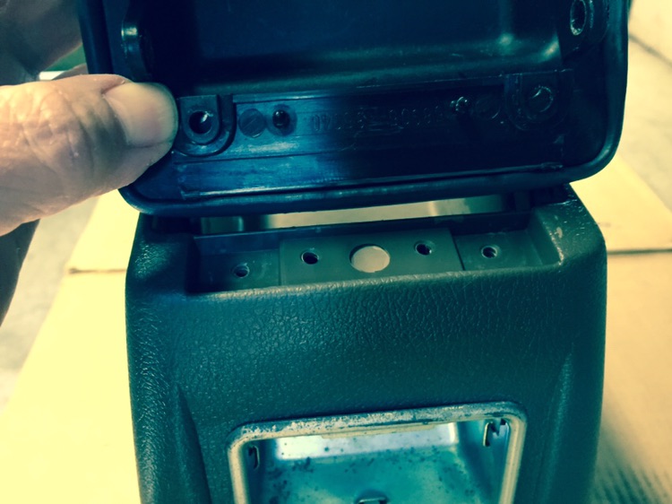

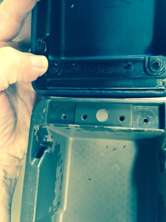

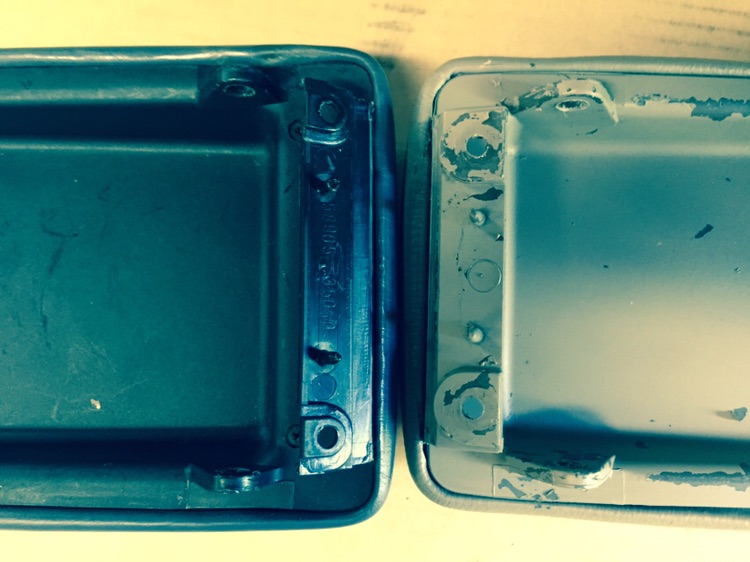

Yesterday I had the chance to compare the later model lid with the 95 and as you can see in the below pics the mounting holes do not line up.
But I think with a little modification it can work. By cutting down either side of the newer lid hinge, actually through the existing mount holes, and re-drilling some new holes that match the 95 console I think it should work just fine. The latching portion of the lid doesn't match up correctly, but I never cared about that anyway as my existing one has never latched since I've owned it. And with just a couple of Velcro pieces you can get the lid to stay closed.
I ordered the 96 lid but won't have it until this weekend or early next week, but when I get it and actually mount it I'll post back so everyone can see how it went.
