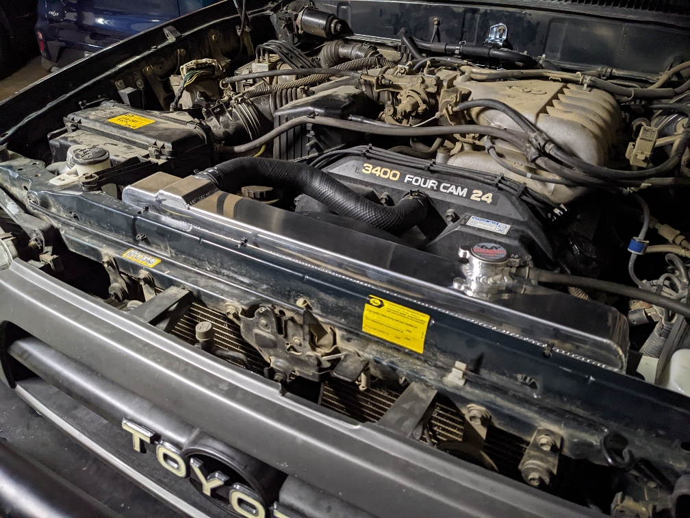

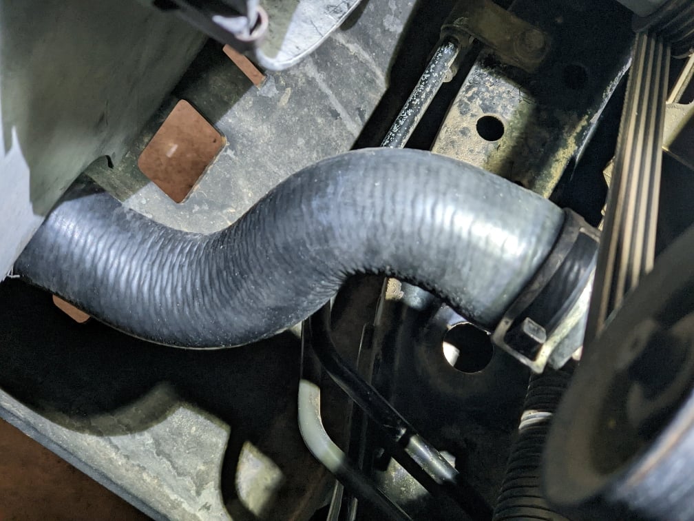

Installed a Champion 1778 aluminum radiator taking a few tips from folks here and there
1990 Camry lower hose trimmed to length
Radiator bottom doesn't exceed frame rails, 18-7/8* core

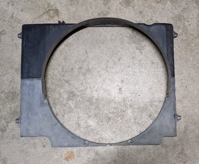

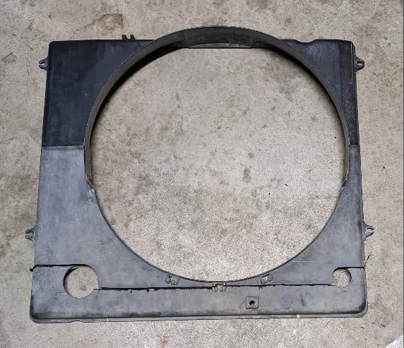

Trimmed shroud

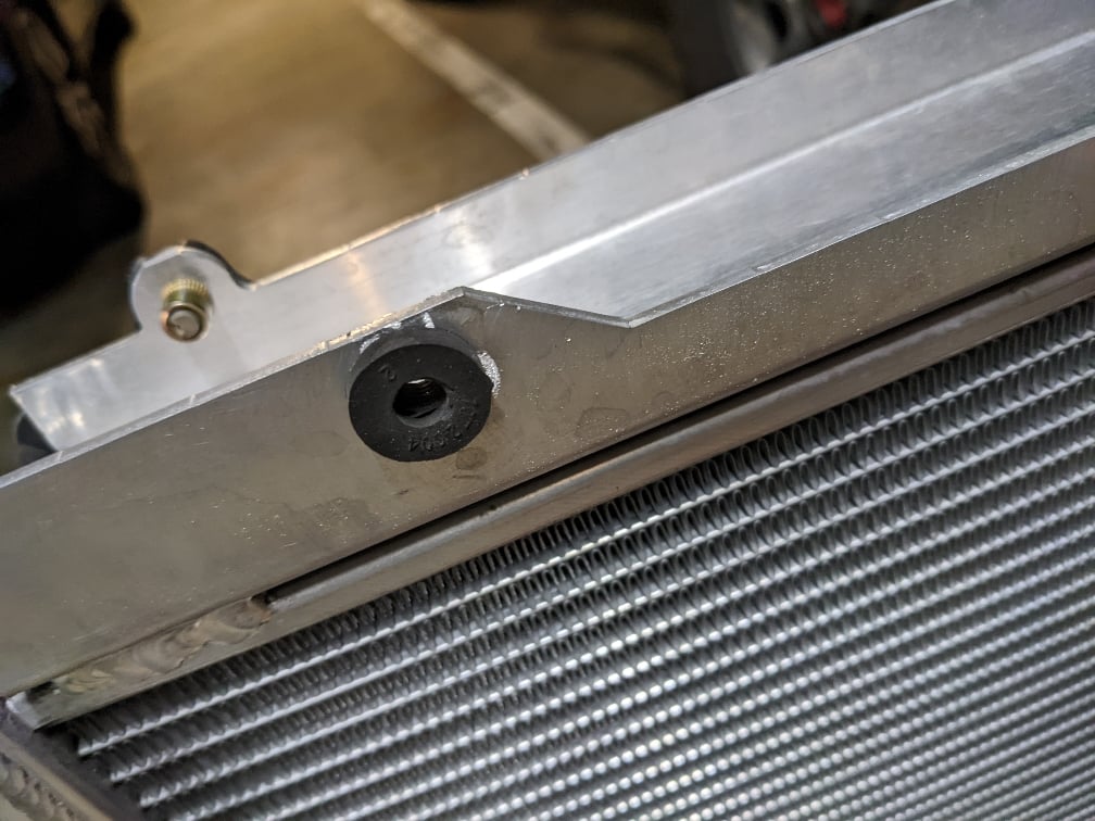

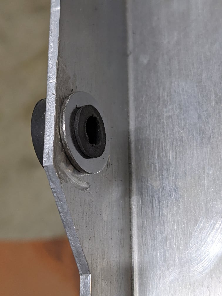

Insulated mounts and SS M8 25mm flange head and nylock nut

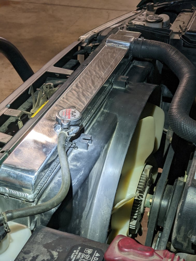

Install was pretty straightforward, no modifications to the vehicle itself. Installed new heater control valve from Amayama.
I did a distilled water flush (3x) before swapping in the new rad, measured water remaining in block after flush and matched with concentrate red, then topped off with 50/50
Coolant volume increased to around 11 quarts, from 9.4 (with rear heater)

Rear heater was a factory option. My 2WD didn't have it. It adds about 1.2 Qts of coolant to the system. I am actually considering removing/bypassing it.

Even though the rad is shorter, the top and bottom tanks hold way more fluid, and are larger than the factory radiator tanks; this rad INCREASED the the total coolant volume by almost 2 quarts.

The stock radiator is (mostly) aluminum. The extra cooling capacity comes from larger surface area (more fins, not the top and bottom tank material) and the fact that the coolant flows more slowly through it since there is more cross-sectional area for coolant flow. Extra volume helps even out temps, but won't have an effect on max cooling capabilities. Aluminum end-tanks are helpful for longevity/reliability, not cooling.
