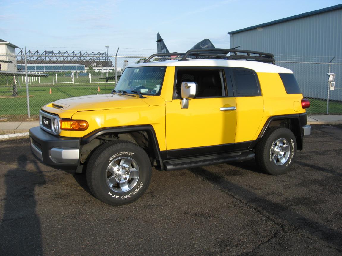

Guys this is the maintenance that I did on my 08 Toyota FJ.
Every 5k miles - Mobil 1 Oil and Toyota Oil Filter
Every 10k miles - Transmission drain and fill, about 3.25 Qts Toyota WS Transmission Oil
Every 30k miles - Transfer Case, Rear Axle and Front Axle, Mobil 1 75W90 Gear Oil
Every 50k miles - Radiator drain and Fill with Toyota Antifreeze
I just sold it in just 4 days last May 2019 with 191k miles and got 55% of the original purchase price.
I will be using the same above maintenance for my 18 4runner.

Your schedule is super aggressive and way beyond what Toyota recommends. Your mileage is great, but far from unheard of for a Toyota following the recommended schedule. It’s your money so please do what you’d like, but that seems like a waste of money when Toyota has spent who knows how many hundreds of thousands of dollars in R&D.
I can’t fault anyone for overkill on their maintenance schedule. It’s just not entirely necessary. Call your local dealer and talk to their service department. I did. I was surprised by how my dealer gave me honest info and lost money on service when they candidly told me what I did and didn’t need to do at the 100,000 mile mark.
