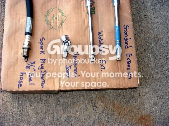

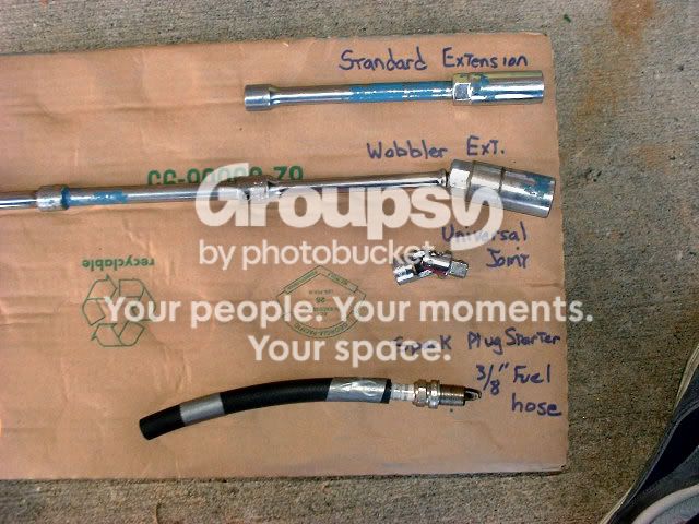

These are some tools that come in handy.
DSCF0019_edited.jpg~original
DSCF0020_edited.jpg~original
I like the Wobbler extension a lot. It allows for some degree of off-set. The universal joint allows more of an angled approach but I do not use it as much as the wobbler. If I cannot start the spark plug by using my two fingers on the plug itself, than I use a piece of fuel line. The 3/8

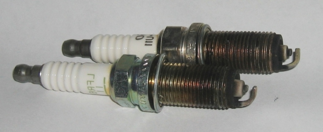

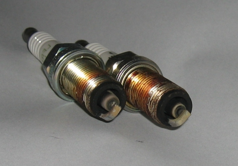

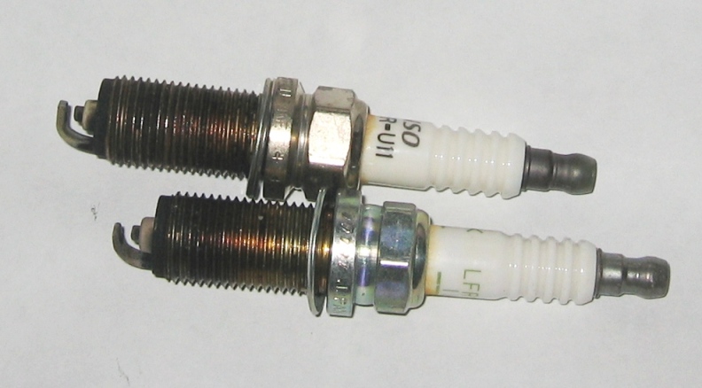

Looks like I have some extra carbon build-up. I'm at 34K and use Hess Regular. It's time to upgrade and so I'll be using 89 octane from here on in.
There are basically three heat ranges for spark plugs (hot, medium, & cold) Your plug is a cold plug so I would expect more carbon on the plug insulation (white ceramic part) than on a hotter plug. As long as the end of the cermaic, electrode tip and ground are not covered in carbon, then it
If it where me, I would replace them all with the NGK plugs since they appear to be cleaner. A carbon comparison of plugs using two different Octane levels would be really nice data.
