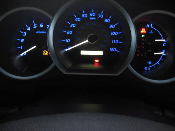

Finally got mine done:
Looks really good! looking to do something like that on my 96 sr5. What bulbs did you use? i can see it has some hot spots like on the 2 on the RPM gauge. Is that avoidable at all?
dash lights on my '10 tacoma. the led's are super tiny and have to be soldered on, im pretty sure they are the same on the 4th gen 4runners.
for the needles I had to scrape off the orange and repaint them with some white fingernail polish. I think there was around 20 leds I had to replace.
