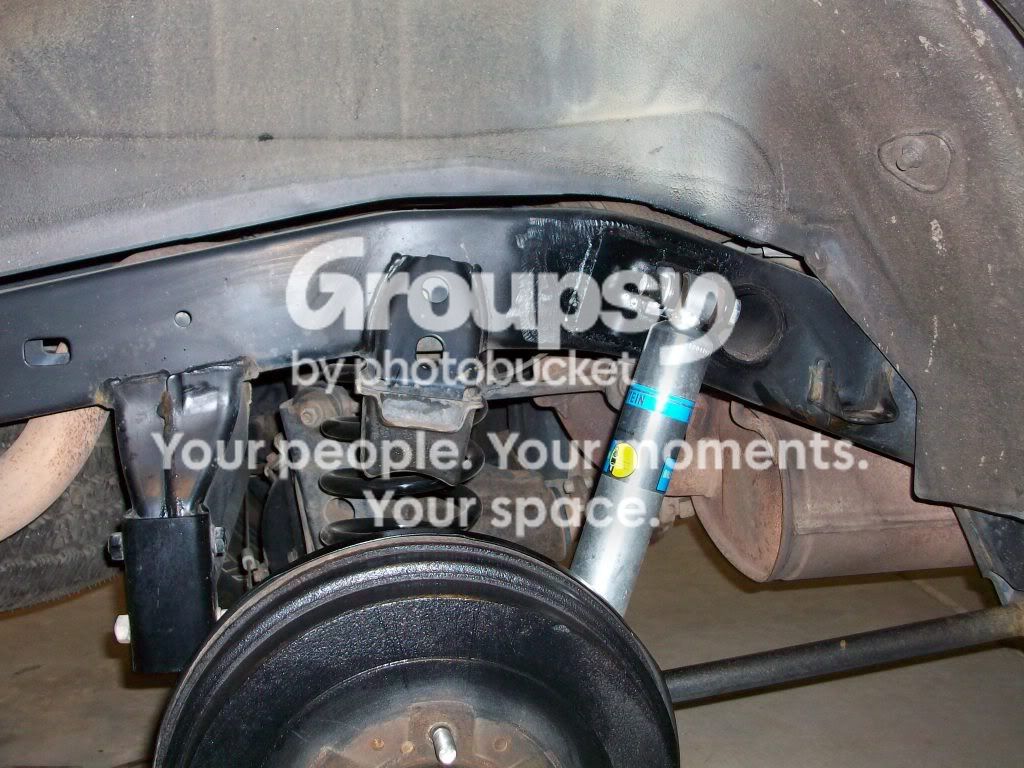

yeah, a few people have done it.. Me included.
Mine.
110_1056.jpg~original
I really like this idea. What size tires and how much back spacing on your wheels do you have? The shocks from Bilstein...what's their part no.? And how much and where did you get them? Also, collapsed length/ extended length? I can fabricate these at work in about 20 min. We have a shear and 20 ton press at work so these shouldn't be that hard. Thank in advance...
-Ted
-Ted
All of that info is in my build thread. The shock info is burried though. They are bilstien 5125 #6253. Google image search "bilstien 5125 chart" and it will give you lenghts and stuff.
