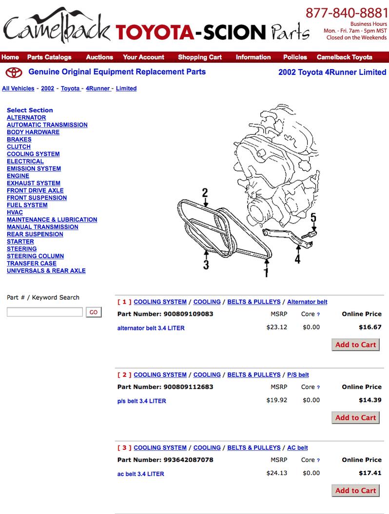

can anyone confirm these are the right part numbers for the 3 belts???

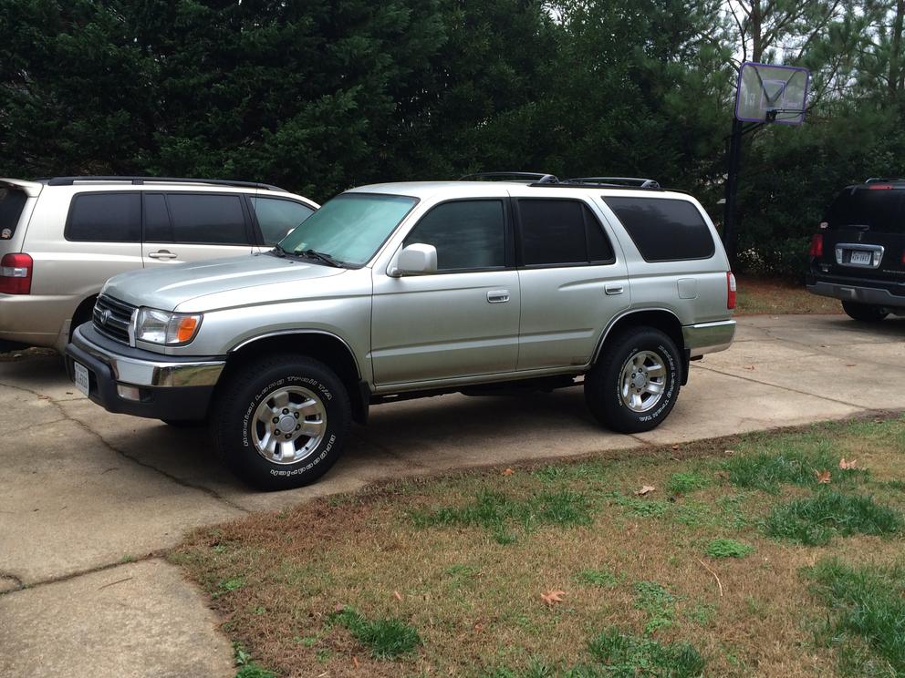

Not a bad look 15 yo Runner
