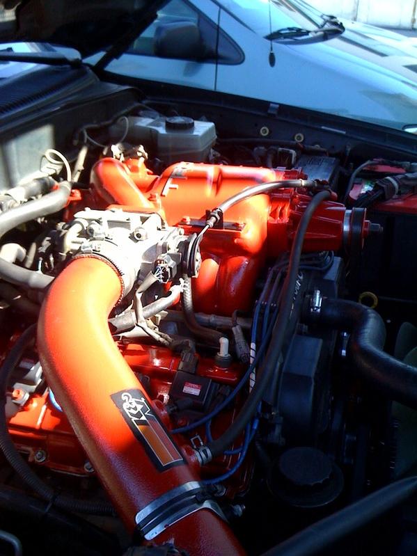

yeah my wiring cover did break in bits... I had to remove my charger , but it wasn't too bad. Just take your time so it won't leak oil. :thumb3:
I recomend the toyota gasket. The replacment gaskets that the previous owner put in a month earlier were leaking(I tried tightening first). They were definately different in molding design. The toyota fit much better and was smooth and flush with valve cover. They were more expensive but this job can take some time and I would hate for you to do it twice. I did not use any sealant. Mine do not leak anymore. Also, I used masking tape to label all the hoses and one of the spark plug gaskets ripped during the removal of the cover. Easy to replace though.
