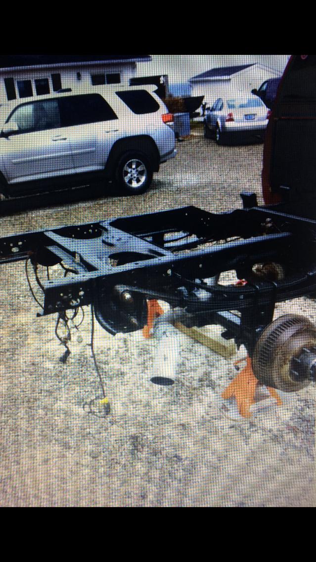

did one of my cummins back in earily 2014 and its due again, now mind you if ya live in one of those god forsaken hot as hell no moisture climate places ,the stuff will last forever,
