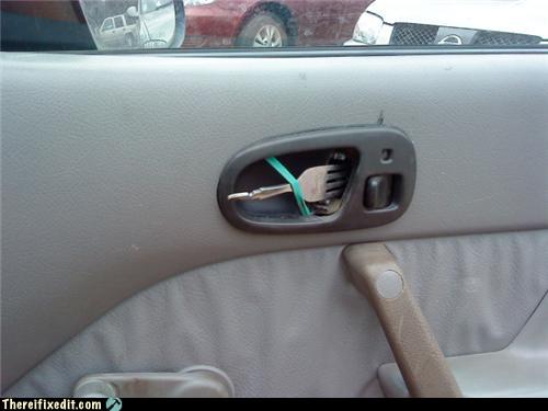

This is a picture of my door handle. Seemed a little cheap when I picked it up ... :bash:
