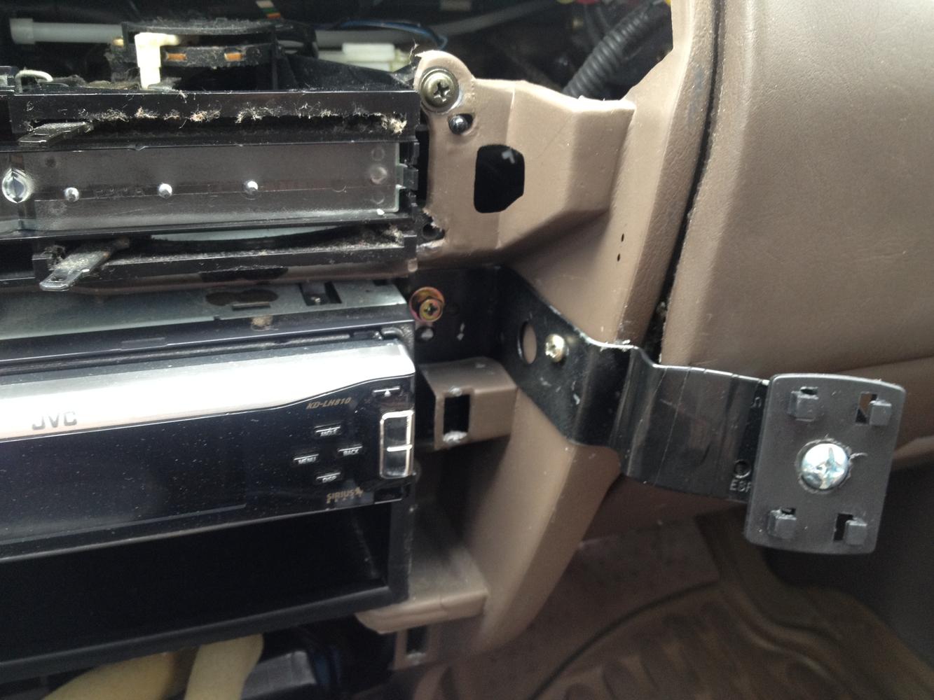

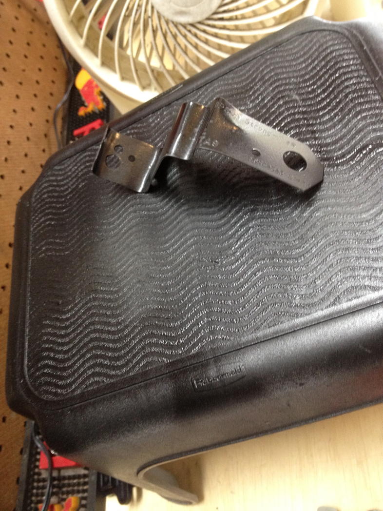

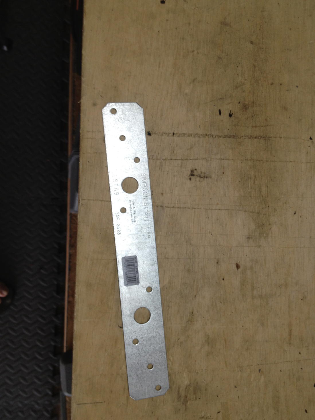

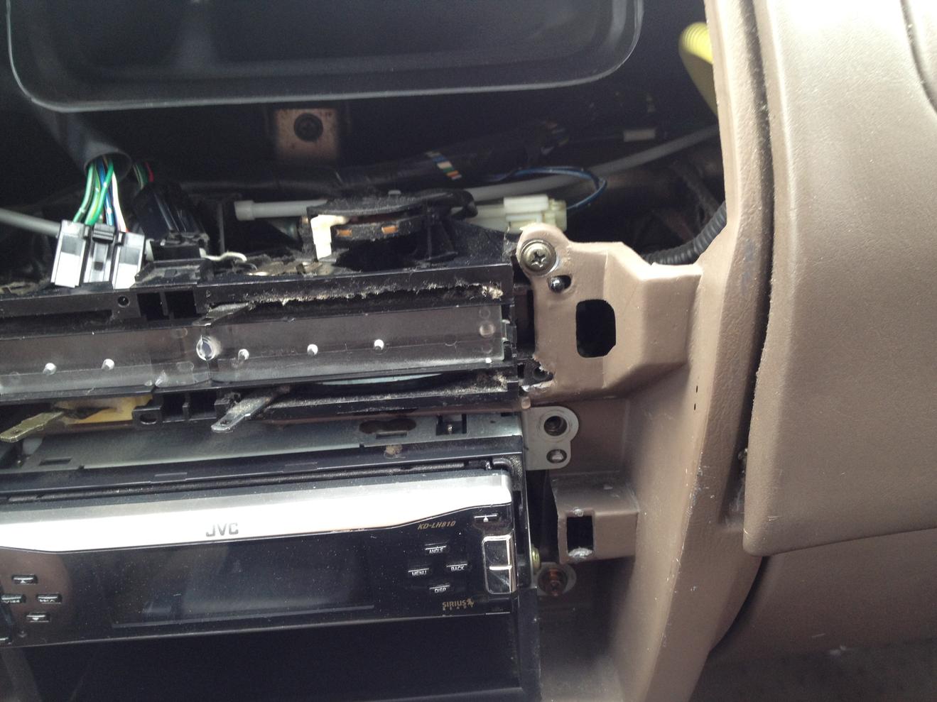

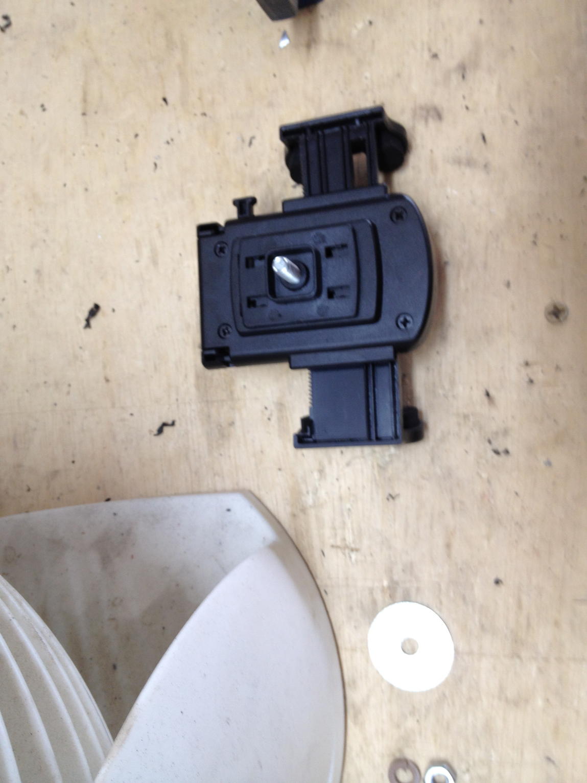

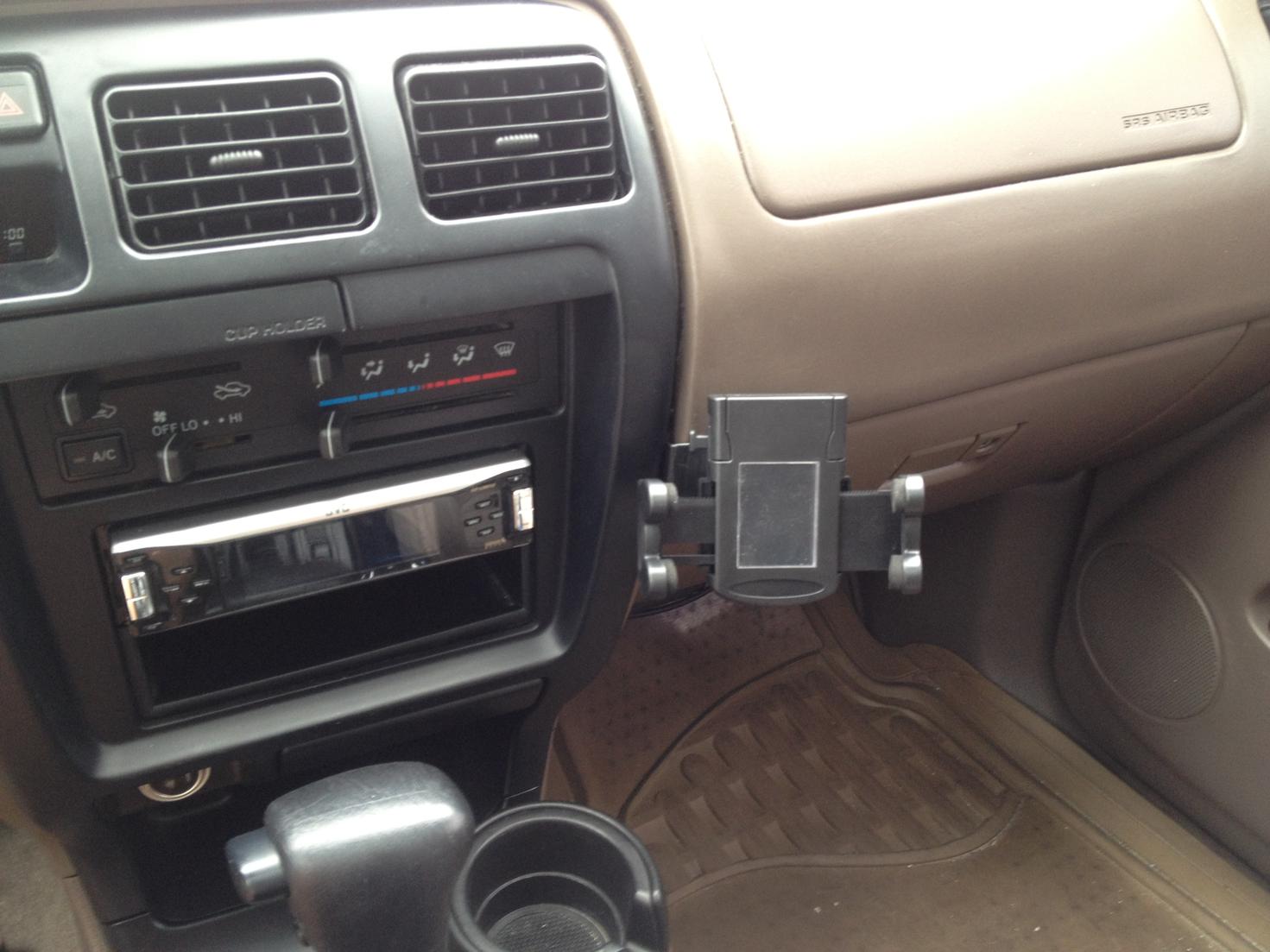

I decided to make my own version of the Pro-clip smartphone bracket I saw on T4R a few weeks ago. $8.50 total instead of $30 just for the metal bracket w/ no holder. Started with a $2.33 flat metal strap from Home Depot. Used two vise grips and my bench vise to bend/cut it to fit, drilled out a screw hole and added a side screw to the new bracket. Painted it black then added the phone "clip" I got off Ebay for $6.00. Had to add a larger bolt to the clip but I had that in my parts bin. Holds my Iphone perfectly and the glove box operates normal. I'd show you the phone in it except its my camera as well, ha. Hope you guys like this cheap and easy mod.
Heres the holder on Ebay.
