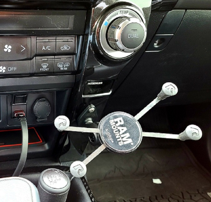

This is a write up of the installation I just performed of a 1” Ram ball. A phone mount to me ought to be:
1) not a far reach away for the hand
2) not too far from where I’m normally looking
3) does not obstruct the field of view out of the windshield
4) one handed operation to mount or unmount the phone
5) secures the phone when off-roading
The actual phone mount bracket I already had and used for years. It’s a home brew hack. It’s the ideal phone holder - not the prettiest but checks off 4 and 5 above. But what I was missing was a way to mount it in a 5th gen 4Runner. The spacing for this was very tricky.

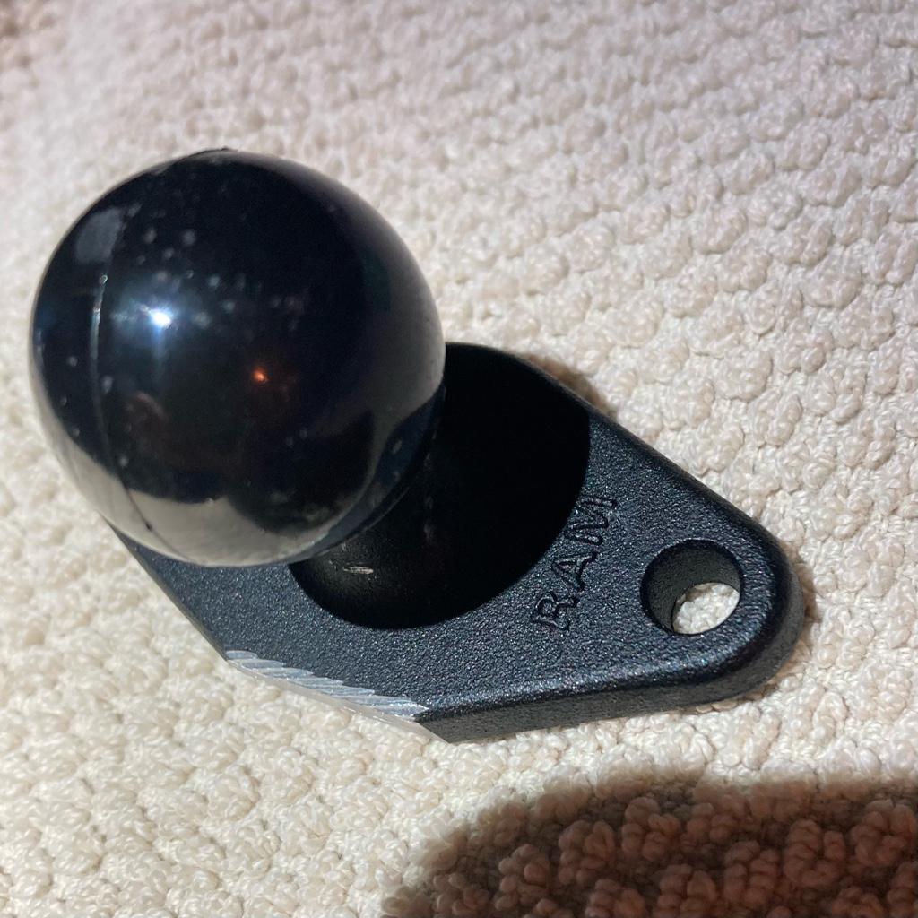

I started with taking a grinder to the Ram mount:

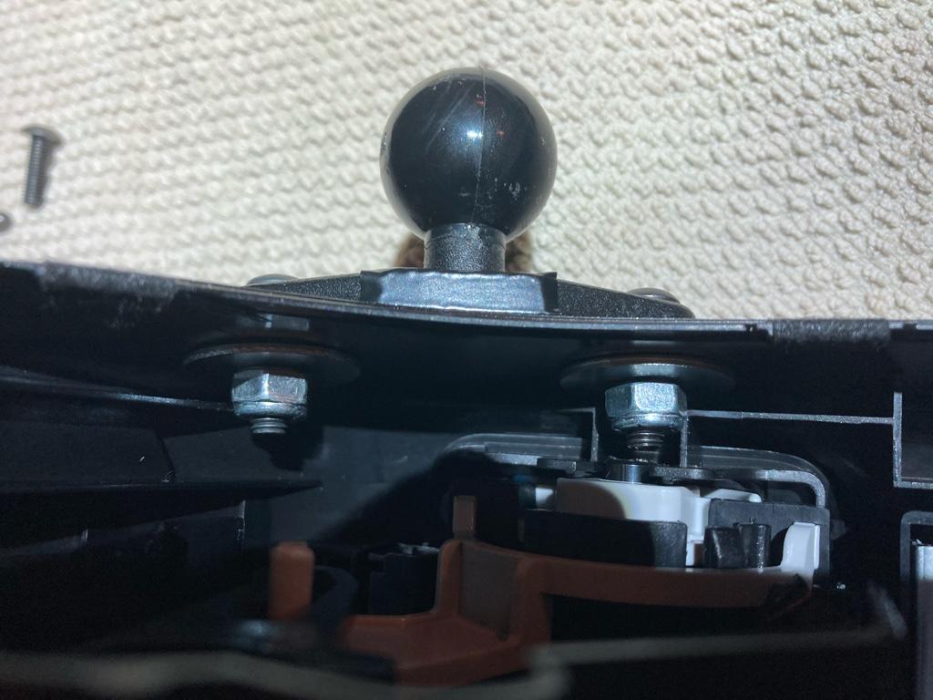

Then I played this game going between placing it on the outside, and then looking at the clearances in the rear.m when the nut and washer needed to fit. I did not want to remove/cut any plastic behind the radio (but this would of been my next step to make this work if needed)

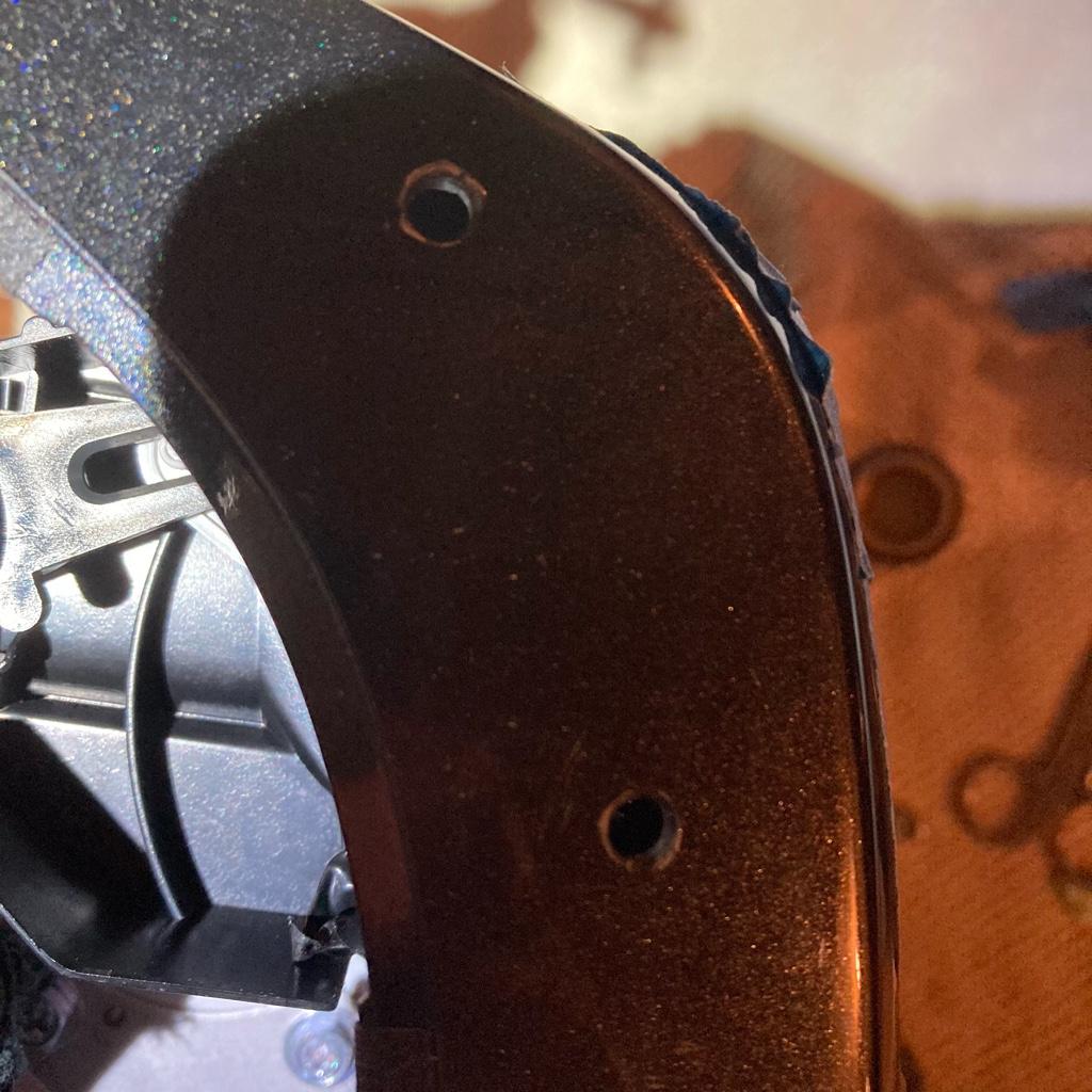

Then I double checked and triple checked before drilling holes:

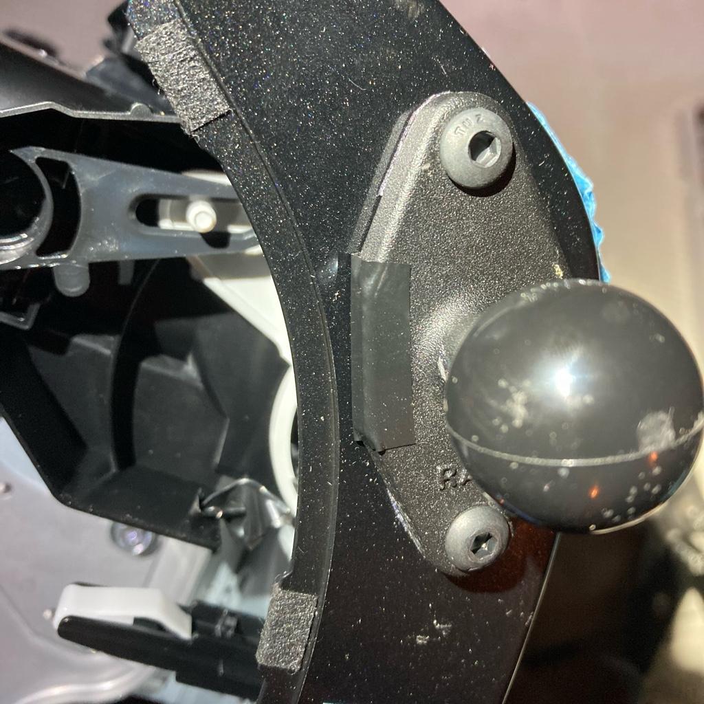

Fasteners used were 10-32 3/4” long. The nuts had plastic inserts (very necessary). The outer hex on the nut was 3/16”. Here are some pics during the installation:
Near where the fasteners go through, small sections of scotch double sided tape was used to help adjust from the curved vehicle surface to the flat Ram mount. A small piece of electrical tape covered where the anodization was removed to prevent excessive scratching.

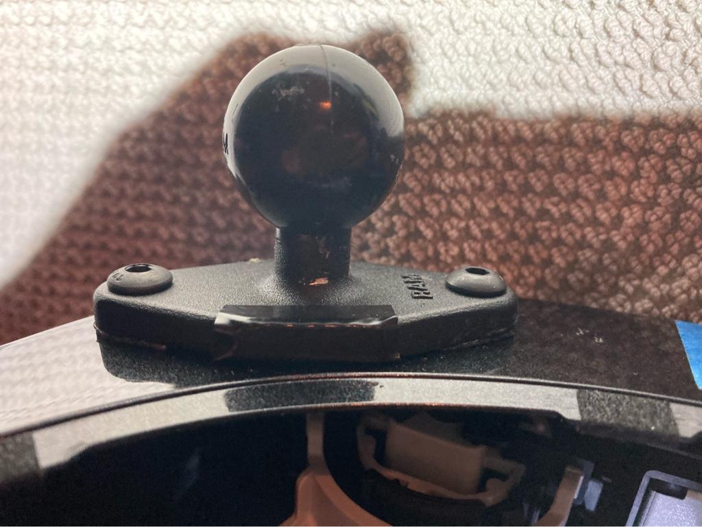

Then the mount added:
The result worked out extremely well. The phone is in the absolute perfect location IMO. Note however the plastic this is mounted to is pretty flimsy as it doesn’t support much weight - therefore this mount is going to pull a single plastic clip in tension. Seems plenty sturdy for my phone but for higher weight bearing screwing into the dash would be better.

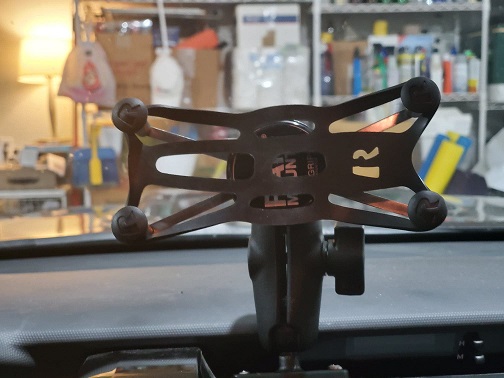

I took a simpler route. Drilled 2 small holes and used wood screws.
Didn't take anything off. Works good been using the hell out of it vacationing in Florida.

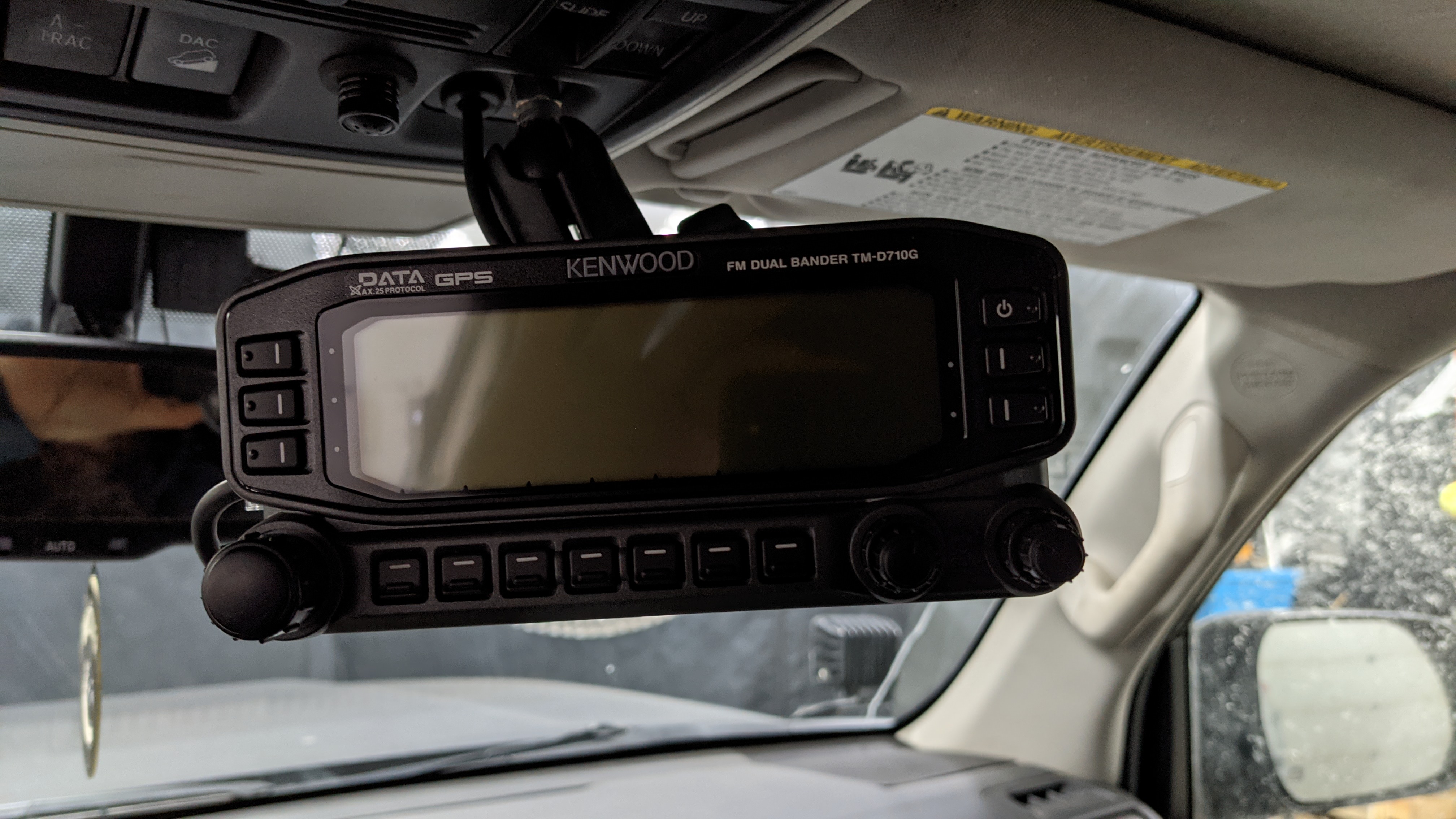

Not sure why that needed to be a write up.... Even more unsure why I read it.... But Ram mounts are super useful, I use their stuff for my fm set up

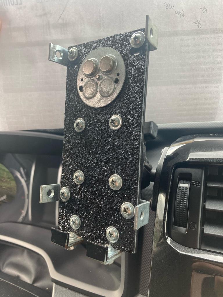

I would integrate a wireless charger into the phone mount. My phone mount uses two magnets to help hold the phone which requires an iron material placed on the phone. This ferromagnetic material would interfere with the wireless charging, so it would have to be placed out of the wireless charging coils. If it’s the new gen iPhone, then the MagSafe charger could be used without additional magnets since it has magnets already. Below are pictures of my phone mount. The black plastic is just 3/16” ABS and the metal bits are corner brackets available from a hardware store.
The magnets I used came from disassembling the amazon ASIN B00PGJWYJ0
For $11. I've used this for years now. Comes with a bunch of little metal plates with double sided tape you put under case on the back of phone. Then I have the mount itself exactly where OP put the ram ball, and angled.

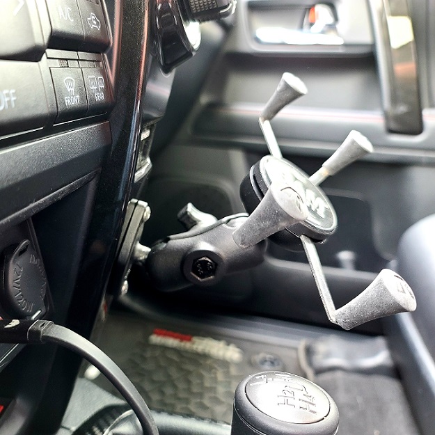

I got the Diamond Ball mount as shown in the OP and mounted that to the face of the lower panel below the red airbag light sort of directly above the transfer case shifter.
It's a nice location and you can get a short high quality USB-C cord that runs Android Auto very well and your phone is not up in clear view of anyone.
No more losing the front cup holder to the phone and no need to have a long cord run up to the top of the dashboard.

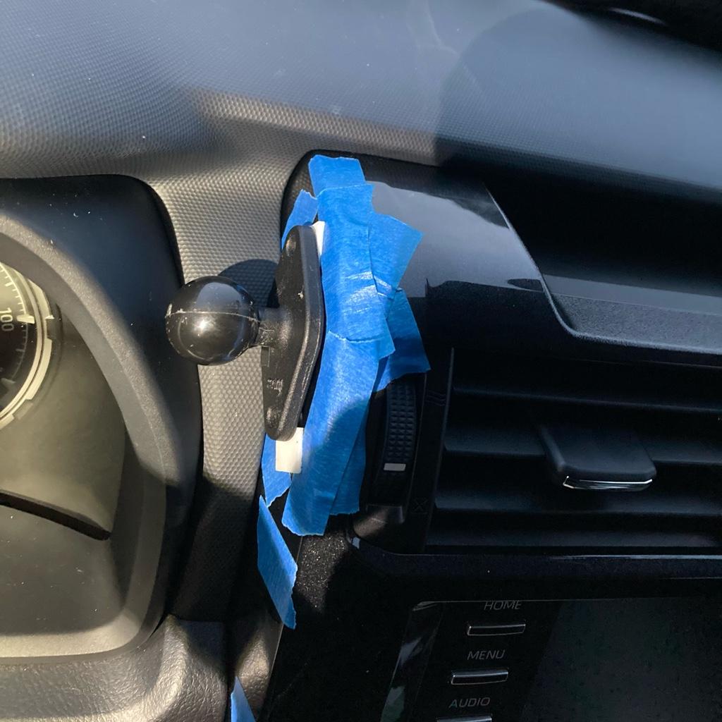

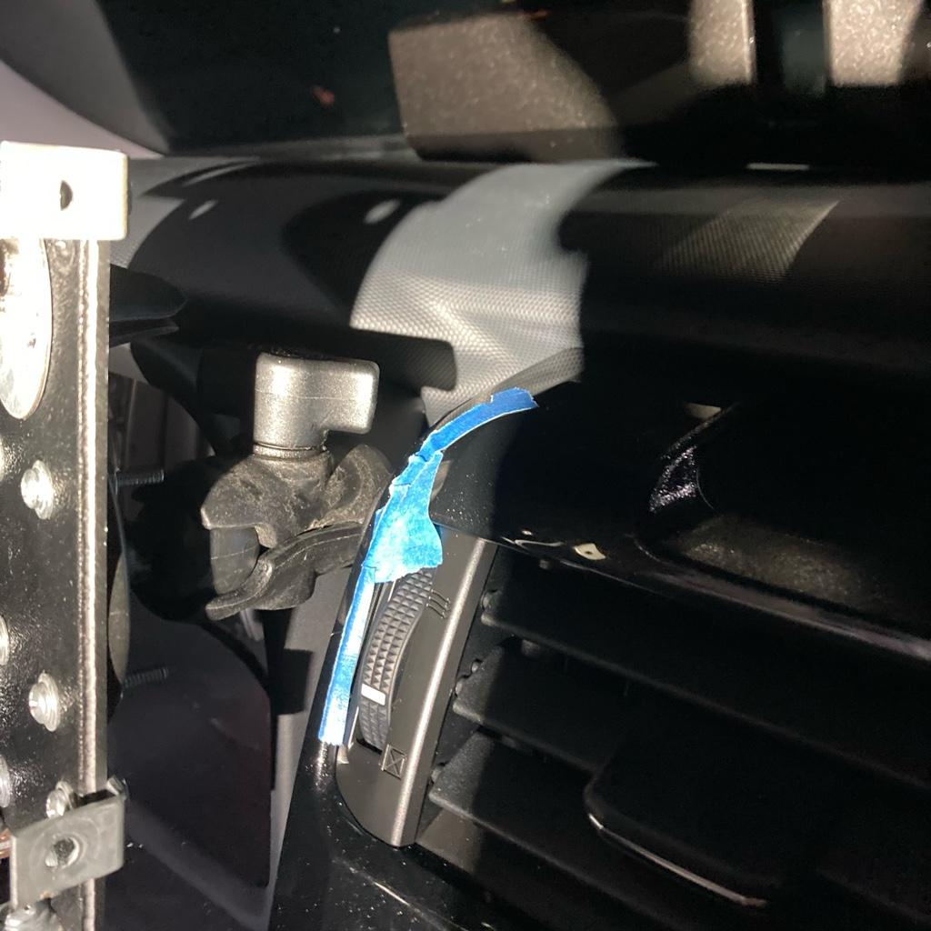

I went to reproduce this setup as I thought it was a great idea...
when I got up in there that plastic you have to ball set into is only held in place by two small screws and I decided against mounting anything there as accidentally hitting anything mounted with an arm would have enough leverage to rip those screws out...
Did you do anything to reinforce those?
Maybe your rig is different... mine 16 TRD Trail Premium.
