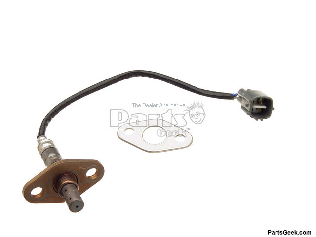

Yeah there is a bung for the A/F sensor, I'm assuming this is what it is supposed to look like?
Is it possible that that my O2 sensor is bad? I remember that URD has that product and I was looking into that as a last resort.
You can take a look at my build thread for the exhaust if you want. It's here. My Exhaust system
My TRD headers came with a bung for the A/F sensor. I'm using it for the AEM gauge. The photo you have is correct. That should be your A/F sensor.

The third bung, or in your case the second bung which you should have but since you went with a straight pipe I don't believe it's on there would be the sensor reporting the condition of your CAT to your computer. This is your O2 sensor on the DOWNSTREAM side of your Cat.
If you don't have it you will constantly get a 0420 code. The way some folks get around it is to "ignore" it or take the CEL bulb out. The other way to get around it for DEQ is to have the additional bung welded in the pipe by any muffler shop and install the URD option.
Yeah, the P0420 is the rear O2 sensor. If it's not connected after the cat it will throw a code.
If it is in there and still throwing a code, replace it.

No problem. I'd be curious to know what actually fixes it. Instead of the URD sensor simulator you can order a new O2 sensor (Denso) and see if it clears. As most have said that's usually the culprit. Good luck.
