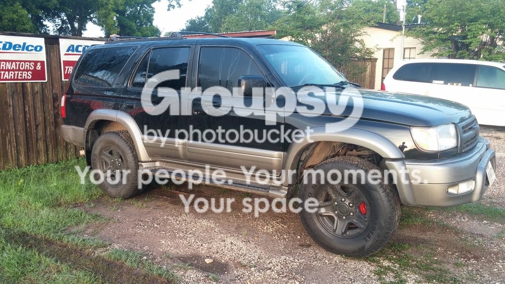

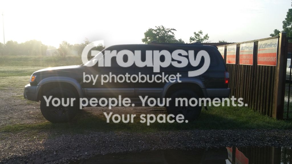

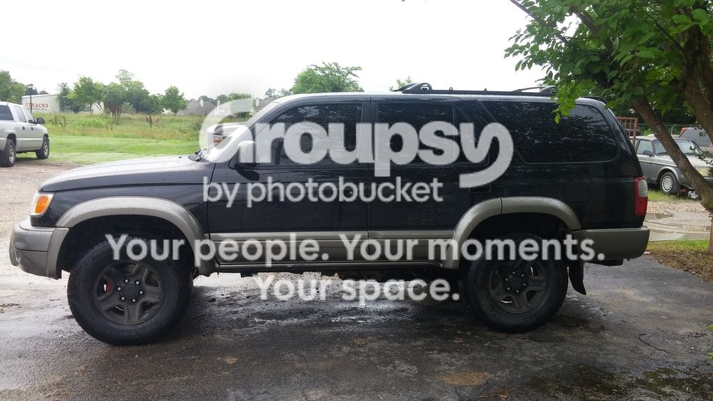

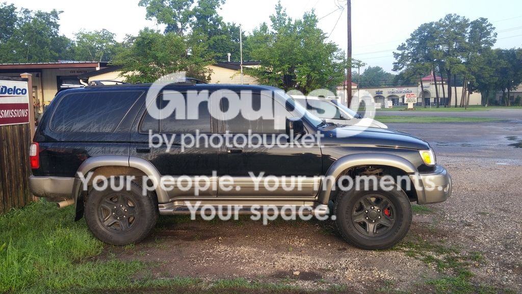

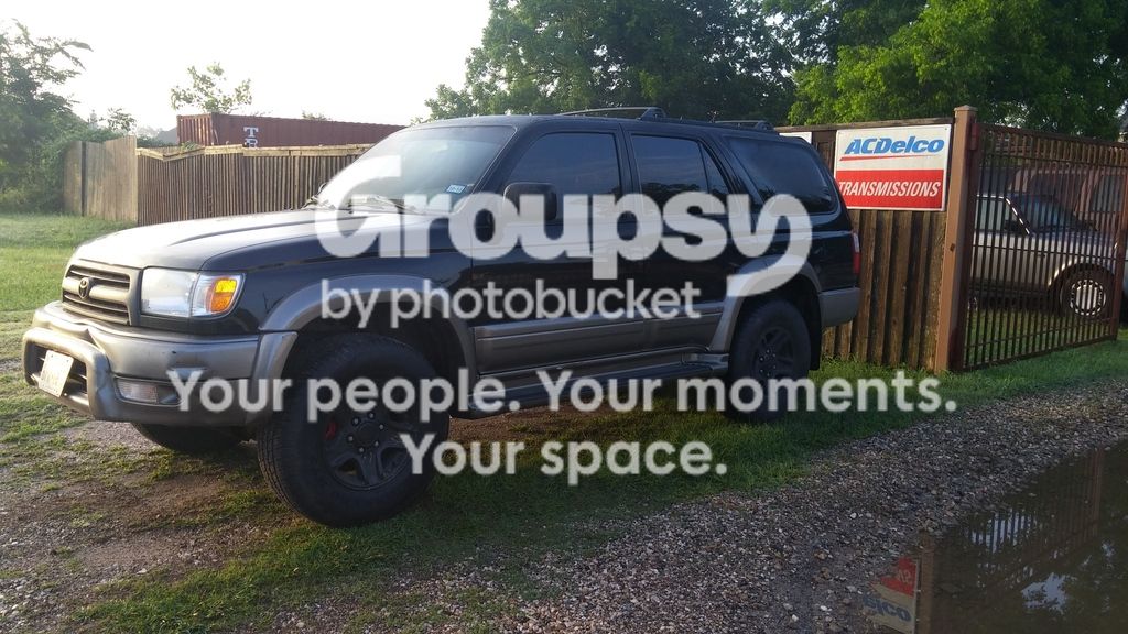

Hey all, just wanted to share my new rig with you guys. Will be building it up slowly as money is tight atm.
1999 Toyota 4runner 4x4 with the E-locker.
What would be the first items to upgrade?
I have already put the beast Tundra brake upgrade on along with some KYB Monomax struts in the front. (old struts were original) :faint2:
Also, my dad owns a mechanic shop and he said the rough country lifts are the cheapest route to go for a lift, but he said he has never encountered any problems. I do realize cheaper is not always the best and I feel like if I get the 250$ kit, I will be suffering ride quality and possibly breaking? I do not do any hardcore 4x4ing, just a few mud spots and hills near my house. Any thoughts?
Great looking 4Runner! Seems like you are off to a good start. One mod I would look at is a tranny cooler. It will help eliminate the risk of the pink milkshake. Also when it comes to the lift I think you are right on... do it right from the beginning. I had spacers up front for many years and eventually changed them out for a legit front suspension. There are many great resource here so take advantage of them. Good luck and again great start!

I'm not a huge fan of lift, so if you're not ever looking for extra clearance (guessing you don't since the running boards are still on) I'd use that money towards something else. You could upgrade to a new audio system that's pretty decent for about $300, more if you want a sub.

Nice 4Runner, looks like you have a clean good starting place. For the lift I wouldn't go cheap. Get good stuff and do it once and do it right. OME and Bilstein is what I plan to go with when I do mine. They're both good brands and make quality parts.
Don't get those HID headlights, they're gonna be crap. They'll look "cool" but are going to shine everywhere and blind everyone. The only way to get a legit HID setup is to do a retrofit with some projectors. That'll look the best, perform 100x better than those other HIDs, 50x better than stock halogens, and won't blind other drivers. I hate being blinded by HID headlights in halogen housings. You can look it up and find all sorts of information on why that's a bad idea and doesn't work well.
If you wan't better headlights without a huge price tag I'd recommend picking up a set of good H4 halogen bulbs off Amazon, because they can be had for a good price and perform better than the regular bulbs that are in there unless they are already upgraded bulbs. I got mine for $10 and they are way better than the OE style ones that were in there.
Make sure you do the mantinence first, like other mentioned. Tranny cooler, LBJ, any bushings, tie rods, timing belt and water pump, fluids, other suspension bits, etc and then start looking at the mods.
