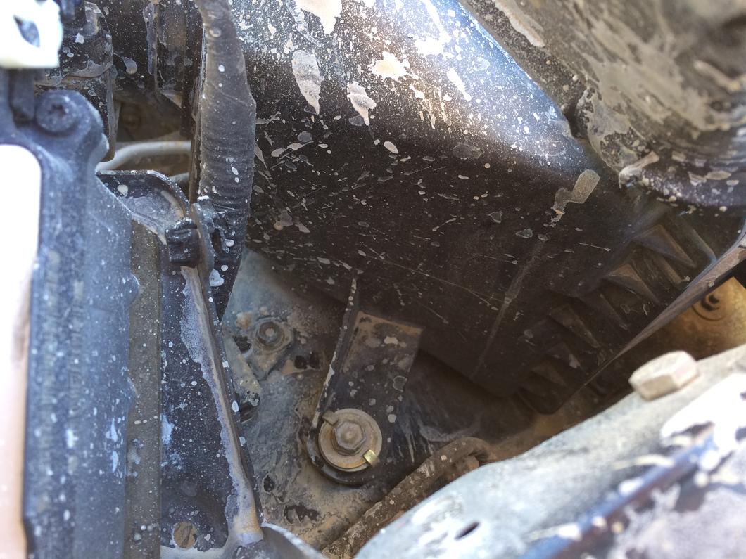

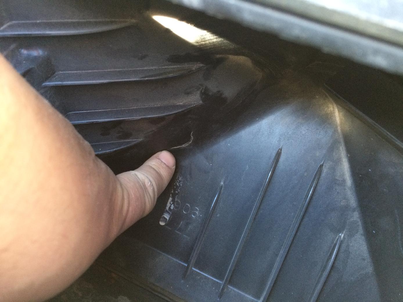

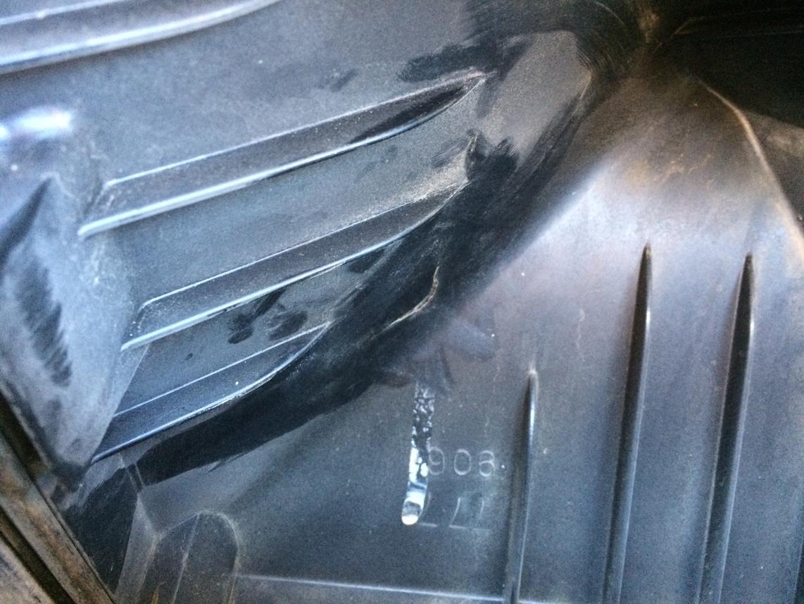

Out in the Mohave preserve, just did a quick air box check after crossing water and found that 3 of the 4 air boxes we have are cracked behind the filter. All at the same spot where there is a support bracket on the back side.
Check your boxes!

Interesting, I'll have to go check mine. But also, I have to say that you have the longest index finger I've ever seen. You're not a proctologist I hope. :D

So, what's the resolution? Does it seem structurally integral, meaning a more supportive plastic weld over or similar, or would a few coats of a flexible caulk do the trick to seal it up?
Since this is on the post-filtered intake side, it's probably a good idea to patch it up. Otherwise, our filter boxes aren't at all water tight, so if it were pre-filter side and not structurally important, I'd just leave it be.
Very interesting OP, I wonder how common this is- I found mine was cracked in the exact same spot a couple months ago when I went to clean my MAF. sealed 'er up with gorilla glue. Easy fix, but kinda concerned how much dust has been sucked into the intake manifold for who knows how long.

My solution to get me back out in the Mojave was to take some JB Kwik Weld I keep in the truck and patch it up. I honestly doubt it will hold as the JB weld dries rigid and the solution is probably going to be useing something flexible. My buddy used some grey RTV on his and it seems to be holding. I just got back into town, so I've got the week to check it out and see if something else needs to be done. Got to get her ready for another trip next weekend!

i have a hole in mine the same spot, but almost as big as golf ball size. currently looking out for a new (used) one.
I have used automotive Goop on all plastics in cars and boats with excellent results. You could also used Gorilla Glue, let it dry, sand and paint....

Yeah I used some rtv to seal up a crack in an EVAP canister with good results. I'm sure it would work here too. Won't be pretty looking I'd imagine.
