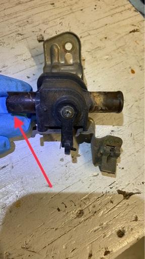

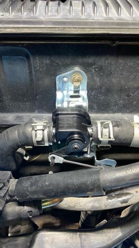

The heater core shut off valve is located top and center of the engine bay on the firewall. Here’s what mine looked like. The corrosion and electrolysis ate the hose barb off of the nipple. This 4runner also had a ton of corrosion in it from its past life, if you have a system with a lot of corrosion in it, it may be very well worth your time to check out your valve health.

The end is near when the valve starts turning brown. I recommend replacing the heater hoses if you replace the valve, OEM is best but I trust Gates. OEM or Breeze constant tension for hose clamps. The OEM valve is the better part. Aftermarket brands like 4 Seasons will work, but buy once cry once right? OH, hit that cable with silicone spray and work it. It makes a particularly noticeable difference with the slider controls on the 96-97.

i will second this info....that they can get brittle. mentioned above...if they start turning brown....they are brittle....like our radiators. however dont wait that long...i had one..not brown...that i bumped slightly on another repair and it broke. have read lots of info an aftermarket not working right. I have a brand new OEM on shelf for next spring.

A word of caution on the heater valve as others said they are brittle with heat and age: if you plan on removing any of the heater core hoses you should be prepared to replace the valve. Often what causes the hose ends to crack and break is when the hose itself is removed. The only time I had any issue with a heater valve is doing just that, removing the hoses. If you're not able to replace the valve such as you are away from tools, don't have an extra vehicle, etc. buy the valve first so you're not left stranded.
