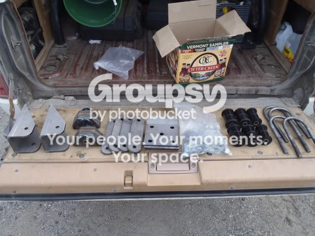

The springs Im using are 2 leaf+overload (not sure yet if Im going to run the overload) Ideally youll want the 3 leaf packs from earlier years, but its what I found around here. From my reading they say they work just about the same, and net me about 2-3" of lift.
Im using the Sky install kit with ubolt flip and new bushings. New lower shock mounts will be welded to the axle and I will be using the Ford-stamped steel shock towers and running the shocks vertically through the bed.

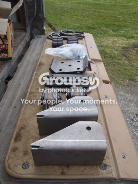

P4150736.jpg~original
Notice the corners of the front hangers are cracked where they bent them. Sky says thats normal and to weld them solid, so I did.

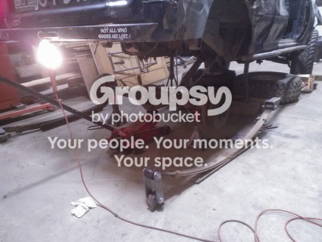

Old parts out:
temporary-117.jpg~original
temporary-120.jpg~original

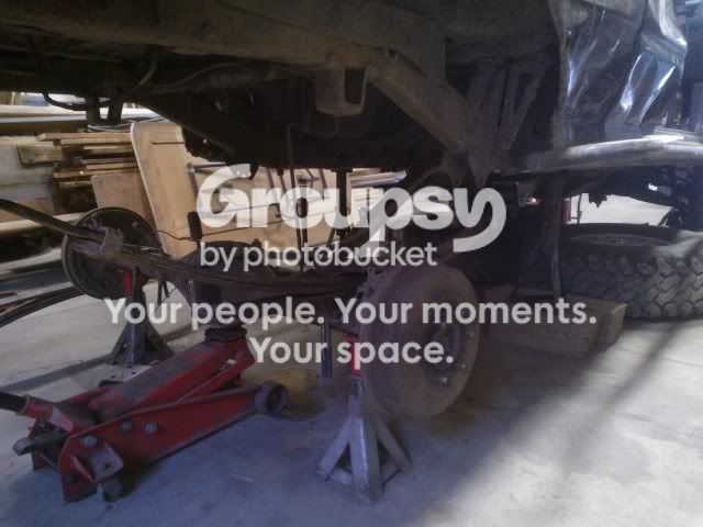

Mocking up new springs:
temporary-119.jpg~original
temporary-118.jpg~original
My front hanger will be moved about 9"forward, but for a 1st gen runner, you want to move it about 11". And the rear hanger goes about 4" back.

And cracks at the bends is not normal.

And fourwd, I checks skys site and it looks like all their hangers have been welded on the cracks... I agree it looks sketchy, but I welded them closed, so I think ill be ok. Ill be watching them though first time I drag them over a rock.

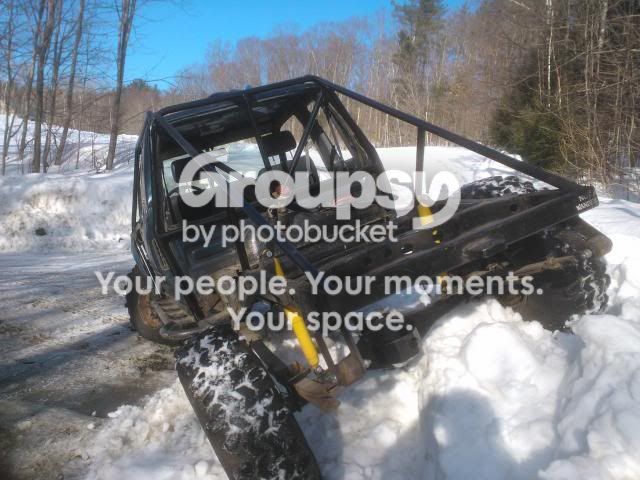

Works very well! Ive only really been testing it this spring/summer after I got the front end "finished." I definitely hit the shackles on stuff, but not as much as you would think. And they are tough.. no signs of wear on them yet. Minimal axle wrap. The 2 leaf chevy springs stuff very well, but dont droop the as well as the 3+ leafers from the earlier years.
My shackle angle wants droopy springs, and these are not, so I could probably get more motion out of them by moving the hanger back a bit /trying different shackle lengths, but that sounds like a lot of work. Haha. If I find a set of the earlier 3 leafers for cheap , ill try them on, see how they do. I also dont have much weight back there.
They are very reliable and cheap to install, and that works for me.
