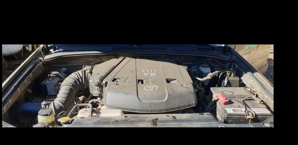

Why don't you post a photo of your engine bay? If it's that different, most of us are probably not be familiar with what it looks like.
There is always a way to make something fit, somewhere.
Just to get the creative juices flowing, here is 40 amp hours I built out of (8) 5Ah sealed lead acid batteries. It was made to install behind the seats of a single cab Tacoma.
You could consider using multiple smaller batteries. Odyssey makes the PC680 that might fit into a couple places. You have options, it just might be a little more custom than what you see around here.

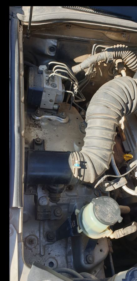

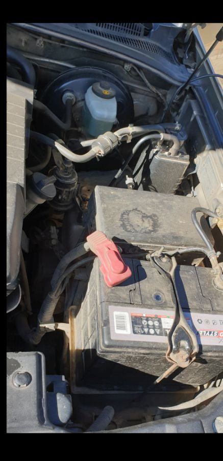

The mod we are considering would be to shift the air admission tube a little bit towards the front of the engine bay, so that it goes almost until the power steering fluid.
This would mean that the space we have for a second battery would be 20x20x18cm instead of of 18x19x13cm, and we could have a 55Amph battery.
Keeping the same pieces (just adding a bit of metal to tie the tube) would make life much easier as international shipping is going to take months, but does mean that the air admission would be from inside the engine bay, next to the power steering liquid. This would be putting the piece which is at the end of the tube, currently just between the engine bay and the wheel, inside the engine bay too. But that shouldn't be an issue, right?
