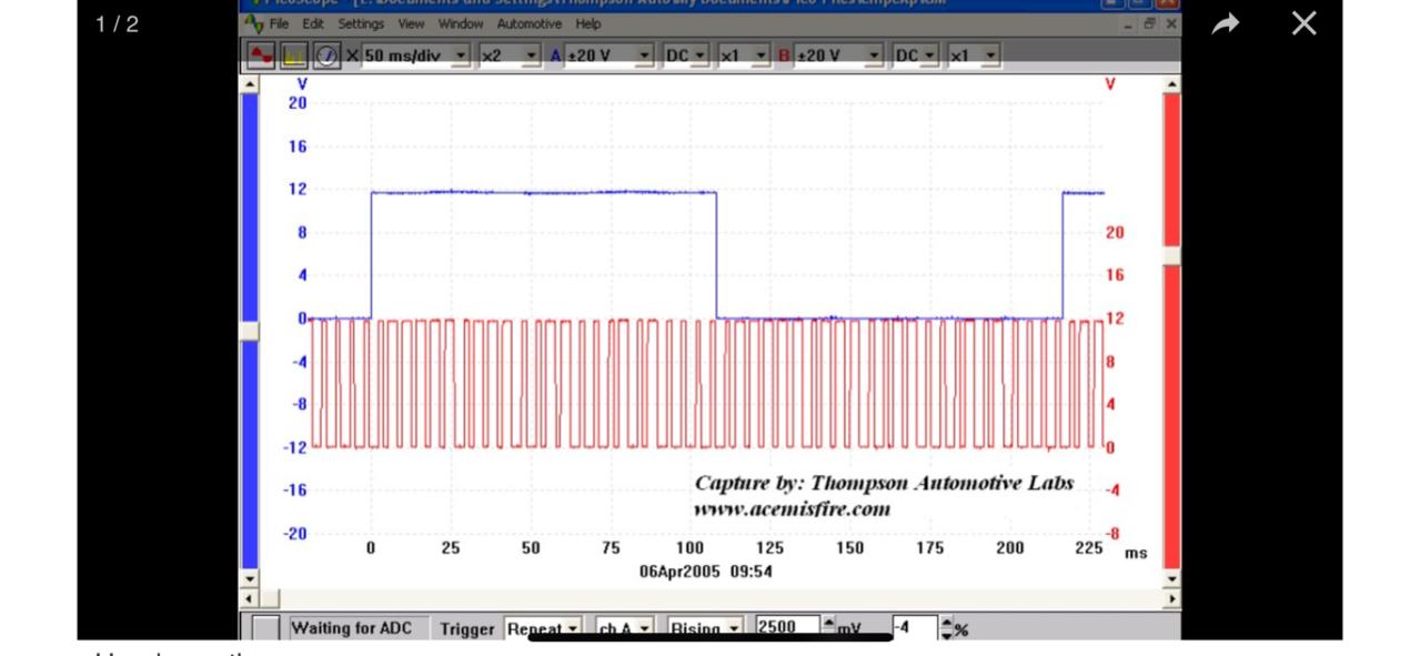

Hi !!
I have a Gen 5 2016 4 Runner but it looks like your timing chain might have been loose and or skipped a tooth caused by maybe a clogged oil control valve causing wear or just a defective OCV...I believe your engine has VVT...that's why you are getting the Cam/Crank correlation DTC...also that will cause the misfire...the ignition system is firing at the wrong time !!...cylinders 1,3,and 5 are on one bank...cylinder 1 is bank 1 so you'd be having those 3 cylinders misfiring but you are only having 2 cylinders missing and you're missing 3...I'm lucky enough to have an oscilloscope so if you were in the NJ area I'd check out your cam/crank. That's why you are getting the P0011...Cam timing is off...the O2 DTC is most likely another separate problem. This is what you would see on a scope. The waveforms would have to line up at certain points...with my scope I could figure out how many teeth your timing chain actually skipped !!...enclosed is a sample cam/crank waveform...the blue is the cam waveform and the blue is the crank...the crank has say a pattern like 5-4-4-3 and repeats...the cam has to line up within that pattern. Hope this helps. I'd change the OCV first, change your oil and if that doesn't help your camshaft/chain might have not been lubed properly...I'm not sure if that valve has a separate filter !!...hope this helps and maybe find a good diagnostic shop and someone good with a scope if changing the OCV doesn't fix it!!
Here is a good video that might help...5 episodes !!
https://www.youtube.com/watch?v=75ptVbCpkjk&t=338s
