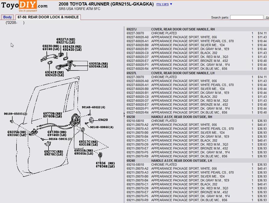

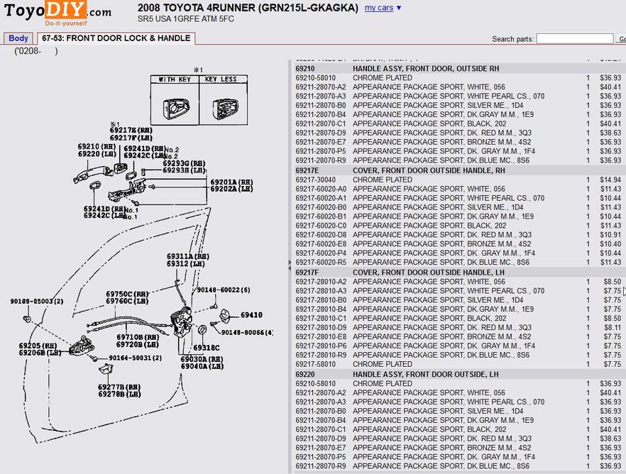

Here's all the part numbers you'll need....

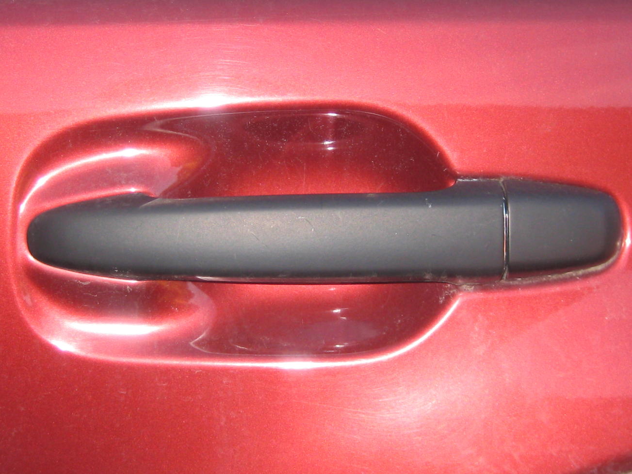

these are covers i painted black and put on about 8 years ago, so im guessing they still should make covers that fit.
