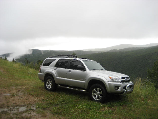

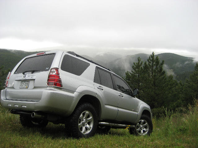

I'm thinking about going from chrome to black with my nerfbars, bull bar and tail light guards.... maybe even the grill?? My question is would painting them with Rino Liner look stupid? Thats the only way I can think of going black with a durable flat black finnish.... paint will scratch and chip fast! I know buckets of Rino liner are avail real cheap....

if you do the rhino liner,its most important to make sure you prep everything correctly. also, RL has a tendency to run, so it would be better to do one section of a part at a time & use thin, even coats. personally, id go with a spray on bed liner. it would be alot easier, or even high heat paint,what ever u do, scuff up first, use gloves so no oil gets on them, clean with rubbing alcohol to get any off, use a paint adhesive (bulldog,etc.) to help hold the primer or paint/liner better. sometimes , things have a hard time sticking to chrome. take ur time, & theres no reason it shouldnt look good!

Powdercoat everything that is metal, tons more durable than any paint and it looks good too. As far as your grill goes if you want to change the finish on that do a color matched limited grill. The grill takes a tremendous amount of abuse and I would prefer to have the durability of an OEM finish.

basically, what he said ^^.
it's not hard to do, but with the round bars, etc... it'll be hard to roll on the liner. if you WANT that crinkly finish, then you'll need to roll it on with a loop roller.
if you don't care, then a can of the spray on stuff (or spray it on yourself, if you have the equipment) would probably yeild a smoother, more even coat.
prep is EVERYTHING if you don't want it to peel/chip later. mask off everything you don't want to get liner on, because it is HARD to clean when it dries.
oh, and read the MSDS well before you start. if that stuff gets on your skin, it's not coming off... and the fumes ain't good for you either.
i used a respirator, disposable paint suit, etc... when i lined my wife's bumpers, grill, and rockers (spray and roll). sweated like a pig, but cleanup was real easy - strip off suit and discard.
