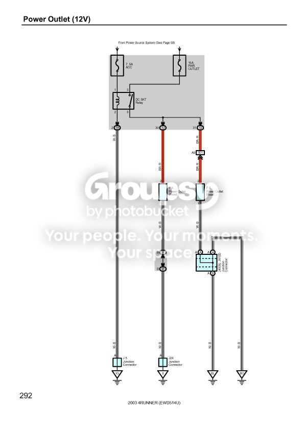

This should help
053po12v1copy.jpg~original
Do you have a multi meter or test light? Do you have power on one side at the 15A PWR OUTLET fuse holder (inside fuse box) or does your horn work (on the same 50A J/B circuit in the main fuse block)? See the attached wiring diagram.
I don't think it's an issue on the ground side because each socket has it's own independent ground path.
