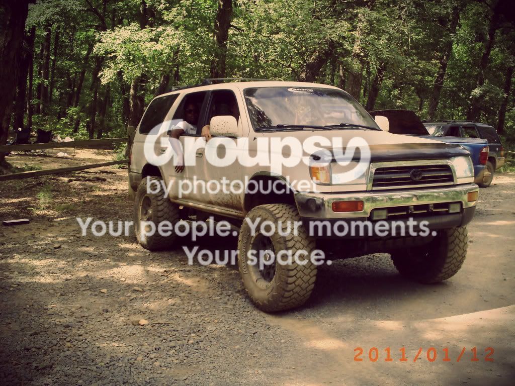

So this whole expensive hobby started out with my first vehicle, 1996 SR5 4Runner.
Learned to drive in this thing and made every high school memory in it. Lotta beach trips, snowboarding trips, and pretty much every stupid thing me and my friends decided to do. Spent every dime I made detailing cars on my 3rd gen and it turned out as a very capable rig. Had a lotta fun out at Uwharrie National Forest with it too.
Damn near washed the clear coat off that truck practically. I guess detailing cars makes you anal about that kinda stuff. But anyways, during the summer of this year. Made a trip town to Holden Beach, NC, same trip we make every year. Well long story short, had some bad misfiring due to a bad coilpack. Replaced the coil pack and made it home after a week on vacation safe and sound. Started the truck the next morning, CEL light came on again with the misfire. So made a short trip to autozone and broke down before I got there. The misfiring had damaged a spark plug so severe that the tip broke off into the cyclinder. So im sitting here with a awesome clean truck, but a engine with low compression, crappy steering (needed a some front end loving, bad bushings everywhere), and gets 14mpg driving like an old person with an eye patch at night..

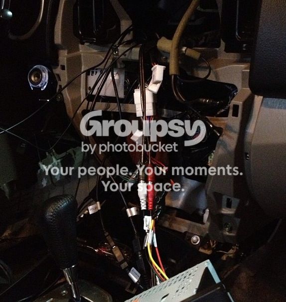

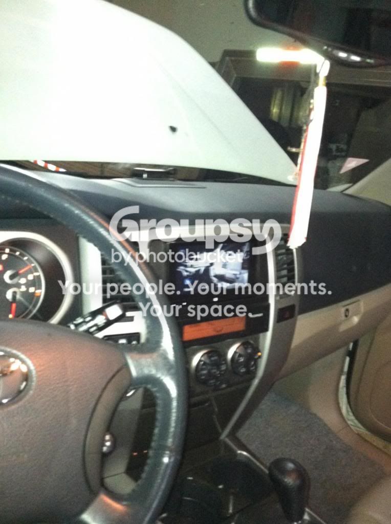

Next thing was to get the radio put in. These are the times where I miss my 3rd gen. Where I could pull my whole center console out in less than 5 minutes, 4th gen's.....yeahhh not as easy. Got my PAC convertor box thing and got my touchscreen in. Took a lot longer than I hoped, everything was a real tight fit.
But it turned out really clean and I was pleased.
But of course, me not knowing to much about 4th gens....one week later I had sweet dash crack over the trim piece above my radio. :ybrick:
Luckly the crack went down to the trim so that it couldn't spread any further, and I have been using aerospace UV protectant on the dash so I believe im in good shape.

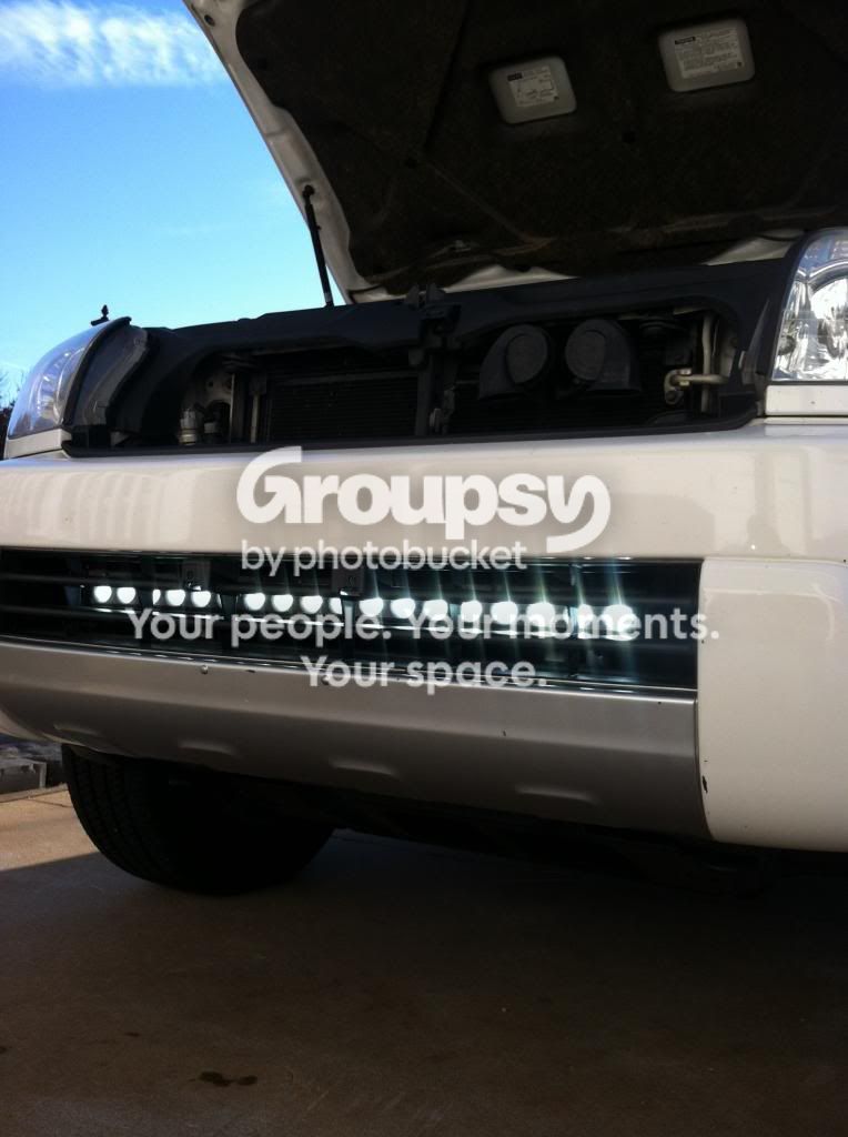

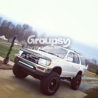

SO! Next major mod was to put in the light bar, and OTRATTW toggle switch. :amen: Had to do some trimming to get the fat switch to fit.

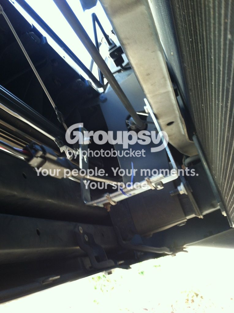

For the lightbar, I wanted to be able to keep it hidden til I wanted to use it and plus, I really couldn't bring myself to put screws threw my front bumper.
So went to Lowe's, found some L shaped bracketing and started playing around with ideas. I ended up putting two six inch brackets together and kinda making a U shape and mounted these brackets to the lightbar.

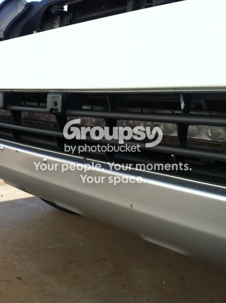

Using these brackets, I was able to attach it to the brace directly below the radiator. The light bar ended up being about 2 to 3 inches behind the lower valence which puts out a decent amount of light. Had to take it on and off several times to get it aligned correctly. BUT, I do love the stealth look of it.
Threw on just a tad VHT tint spray to keep it stealthy. :behindsofa:
