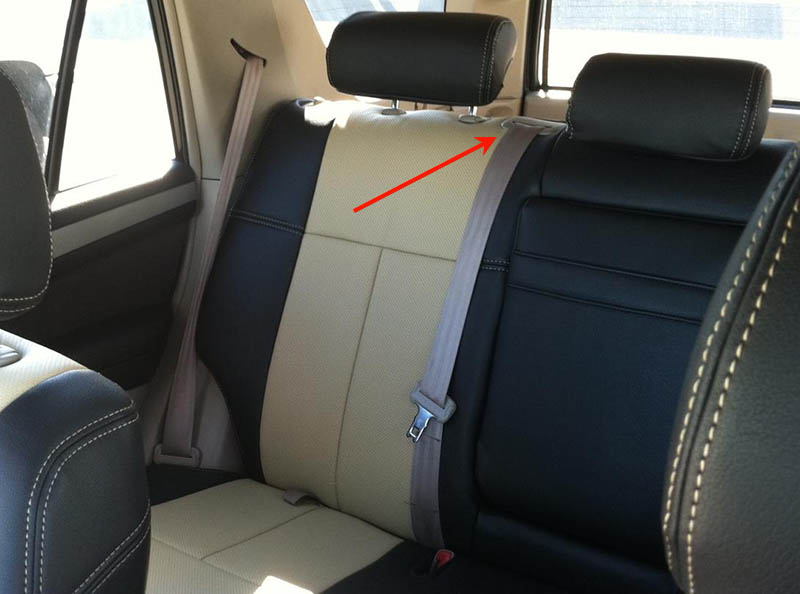

The installation is now complete. Overall, straight forward & not difficult. I would recommend having a look at some of the You Tube Videos. They give a nice overview of the install.
Your seats look great!
How do they handle the rear center seat belt? Do you have disconnect the seat beat to get it through a pre-cut hole?
Also what do they about the arm rest sliding tray? I have pulled mine apart to repair the broken pivot and it's a pretty straight forward job.
Daren

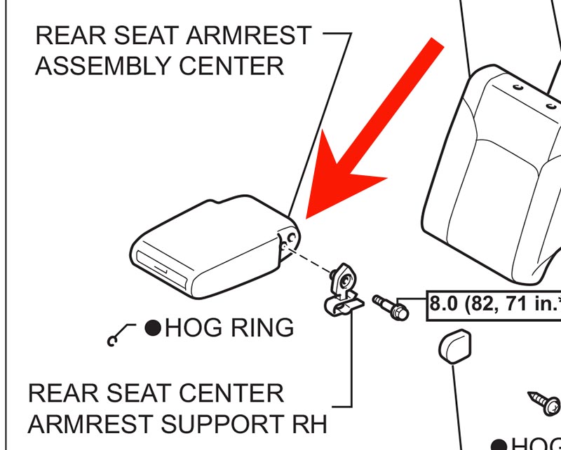

Where did you get parts to fix the broken pivot point? How do you take the arm rest out? Thanks for the help.
There's a bolt (82 in attached image) that you remove and the arm rest pivots out of the armrest RS supporting pin.
The armrest supporting bracket inside my arm rest was broken. I removed the cover and slide out tray, then fit it back together enough for it to stay in place for a trip to the local muffler shop. $20 later and some water on the foam to keep it from catching fire, it was repaired.
After I got home, I cleaned up the weld and put everything back together. I normally don't carry passengers, but at least it doesn't fall out when I put the seat back up. :p
