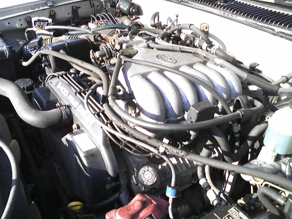

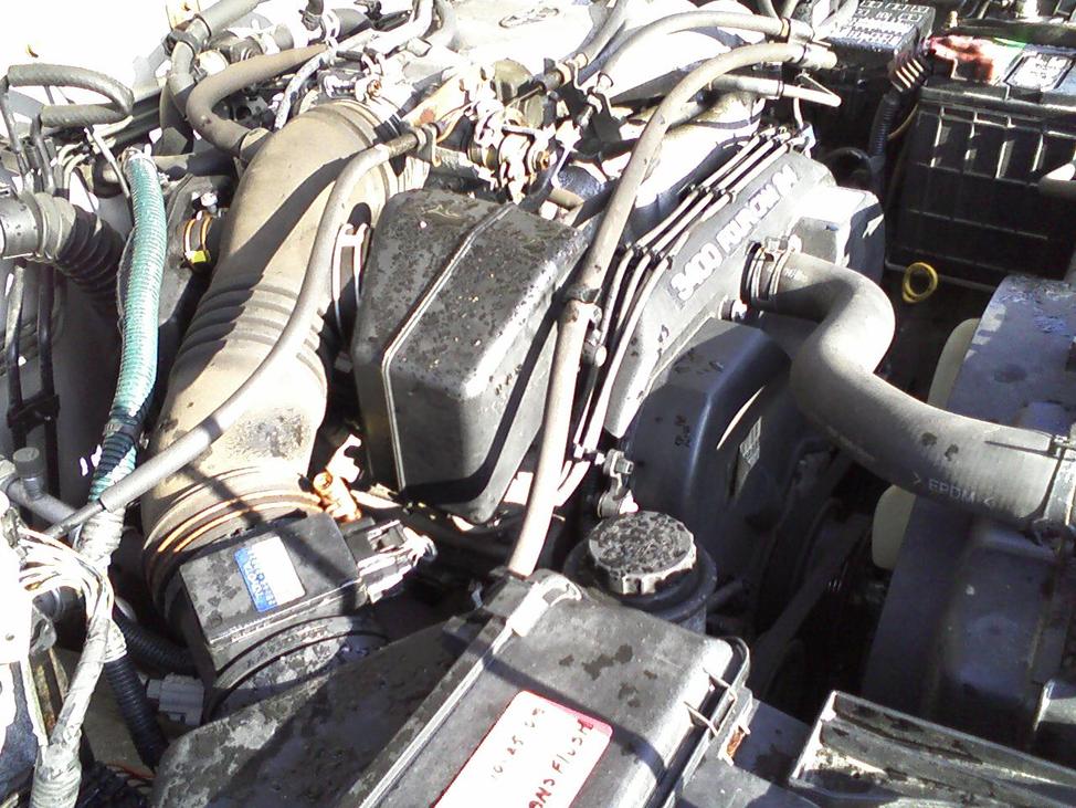

vooduguru......you are soo right....here are some pics....not really good, but ok...
Cheers
