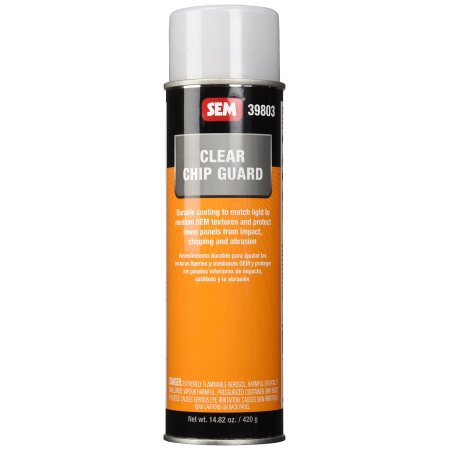

If you go the clear coat route I wouldn't use regular clear coat. I'd use chip guard clear coat which has a bit of texture in it.

Chip guard clear is used on rocker panels and the lower parts of doors. If you look closely at those spots on your 4Runner you can see that it has glossy texture compared to the rest of the clearcoat on your truck. It's because it is a thicker enamel paint that is more chip resistant than regular clearcoat. Get a few cans and put 2-3 coats on each slider and you'll be good to go. If I didn't bedline my sliders I would've painted them up and used chip guard as clear over it.

Is there a specific product you might recommend? And do you think I might have issues with flaking and/or yellowing since there would be no primer/paint for the clear-coat to bind to?
I use SEM clear chip guard. Honestly I have never clear coated just bare metal. Your gonna kind of be the guinea pig here. But I can give you steps to follow so that you'd have the best chance at it turning out.
1. Clean bare metal using acetone or SEM makes a degreaser called SEM Solve. Some of the stuff you get comes with applicator brushes.
2. Apply the chip guard in thin coats. This stuff runs really easily which in your case probably won't affect the finished product. But when I use it over paint I have to be careful.
3. If it's warm out give it like 20-30 minutes between coats.
