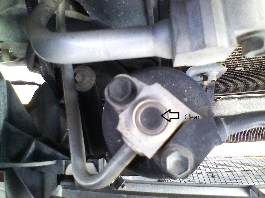

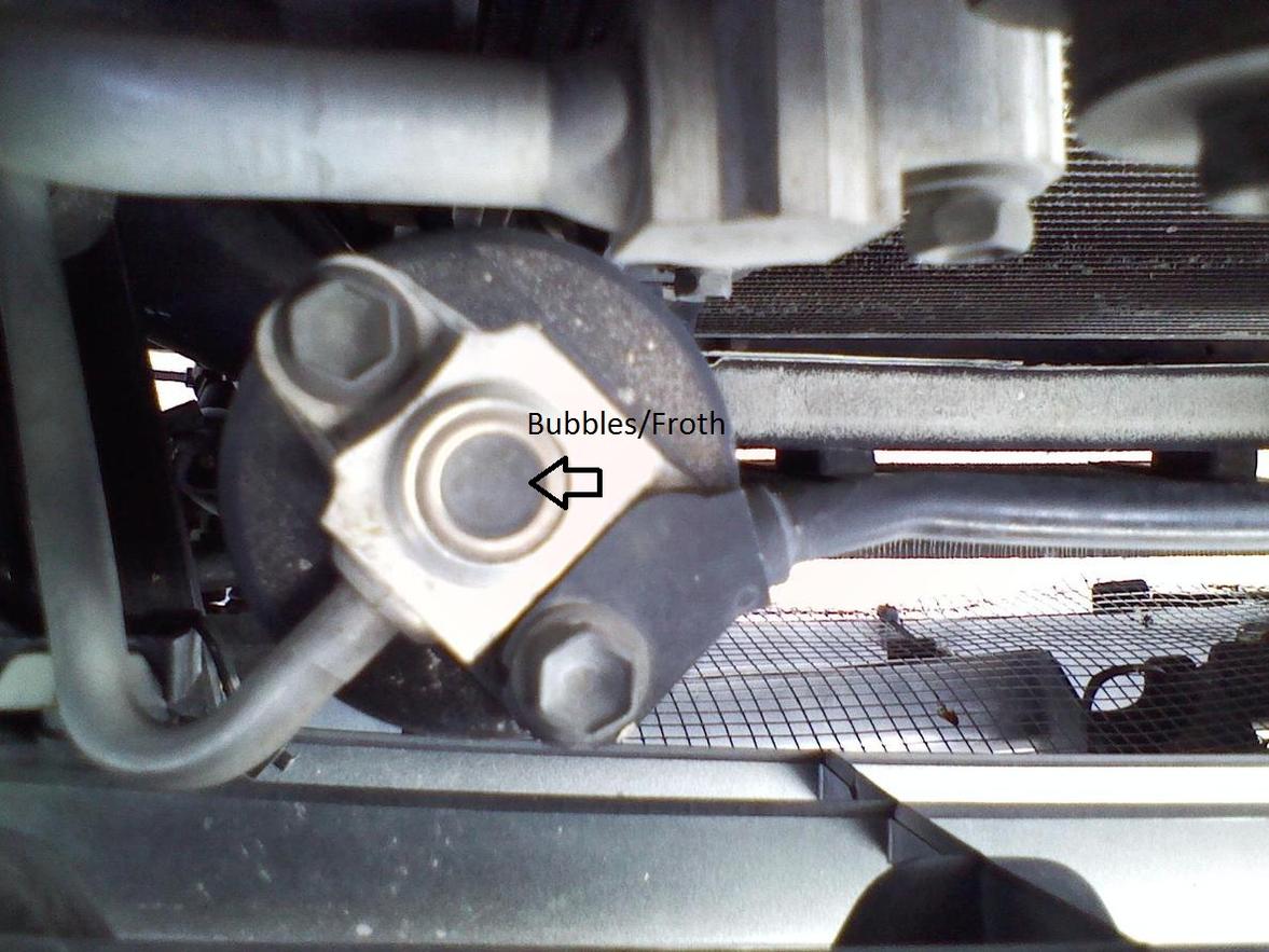

Freon
Locate the AC filter (in front of the AC condenser next to the horn). On top of the filter there is a glass window to watch the freon (1st picture: bubbling low on freon). I recharge the system today after owning the runner for 7 years. I recharge it until there is no more bubbles inside that glass window. You may see a bubble or two while the AC is running but not lots of bubbles (2nd picture). Then that's it.
What is that grinding sound? It can be the bearing inside the AC idler pulley or the AC compressor. Both are super easy to replace and DOES not need to recharge the system.
You can remove the AC belt and spin the idler pulley and listen. It if makes a noise it needs a new bearing. Bearing is like $6 and you can press it in to the pulley or buy new pulley for like $30. You can also spin the AC compressor pulley and listn to any sound. If it is, then the bearing is about $22 (not OEM) and you can still insert it. I can make thread on it if you want me to.

You might actually be overcharged. I found that the FSM spec for pressure is actually at the very low end of the green on those cheapo self-charge cans. I use real gauges and go for the FSM spec of 22-36 psi on the low side and 198-228 on the high side, with engine at 1500 RPM and A/C fan on HIGH, and with temps in the range of 86°F-95°F. 22psi was well below the green zone on the cheapo can.
See page AC-4, par 2.1. My psi numbers are the conversions of those numbers shown in MPa.
http://tacoma.site40.net/4Runner_96-02_Repair&Wiring/techinfo.toyota.com/ileaf/02toyrm/02toypdf/02rmsour/2002/024runne/ac/acsy/ovi.pdf
I can't read the numbers on your can, but on the one I had 36psi, the high end of the recommended low side pressure in the FSM, was right at the lower end of the green. At that level, my system works fine and the window stays clear as it should and foams when turned off, as it should. There are variations according to temp and humidity so YMMV.
To verify if you are overcharged, observe the sight glass when you turn of the A/C. If it just stays clear, you are overcharged. At correct charge, it should foam and then stay clear. See the chart on page AC-3 in my link.
After working with real gauges, I am no fan of those parts store cans.
