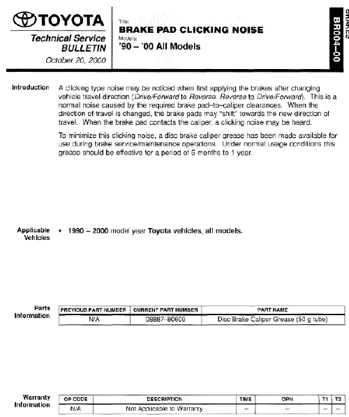

I have noticed (after I bought the vehicle) that when I am slowly reversing or going forward (about 4mph) I hear what seems to be sloppy brake pads making a moderately loud clicking/knocking sound.
I am assuming this is due to smaller pads than what should be there, or something worse... While driving under normal conditions, there are no problems with the brakes. I am just concerned something might happen when I need to brake in an emergency.
