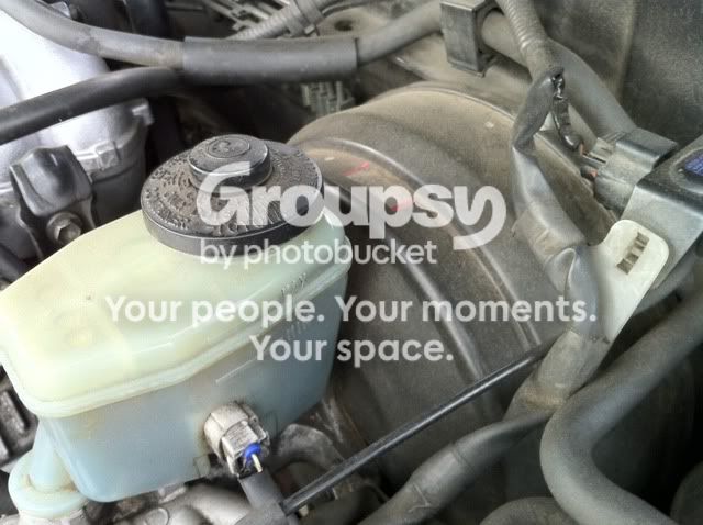

UPDATE: So I decided to listen to the sound again, and noticed it's actually not coming from the engine but this thing. I'm not sure what it is. Has anyone else ever experienced this?

Yeah, mine is doing the same thing... But I believe from the post above its coming from the evap cannister... so you may want to try replacing your gas cap... I just put a new motor in my 96 4Runner, so naturally I was freaking out...
My 97 4runner does the same thing but I have 205,000 miles on it and the noise is coming somewhere from engine. I want to fix it but Idk what it is
Not trying to say its not a valve tap, but open the hood while it is tapping check on the driver side fender well next to the brake booster on he evap canister. It has vacuum valve that sounds like a valve tapping when it comes on. Mine does that at idle from time to time and will throw a Evap malfunction code. It happens when the gas cap is not venting properly and the valve kicks on. I have yet to buy a new gas cap I just reset the code and drive some more. It only happens @ idle and will throw the code if I run it low on fuel. Just a suggestion, cheaper to replace the cap than it is to get a valve job done
This is exactly describing the ticking issue that just started for me yesterday, but as of yet I'm not getting a CEL. I will hook up Torque and see if I am throwing a code.
It does not sound like a valve, and it definitely sounds like it's coming from near the brake booster as opposed to the engine block. I immediately thought vacuum issue of some sort. It only makes the tick at idle RPM, if RPMs go up, the tick goes away instead of matching the RPM increase.

That is definitely the click I'm getting. Looks like I need to replace or clean the vacuum switching valve.
