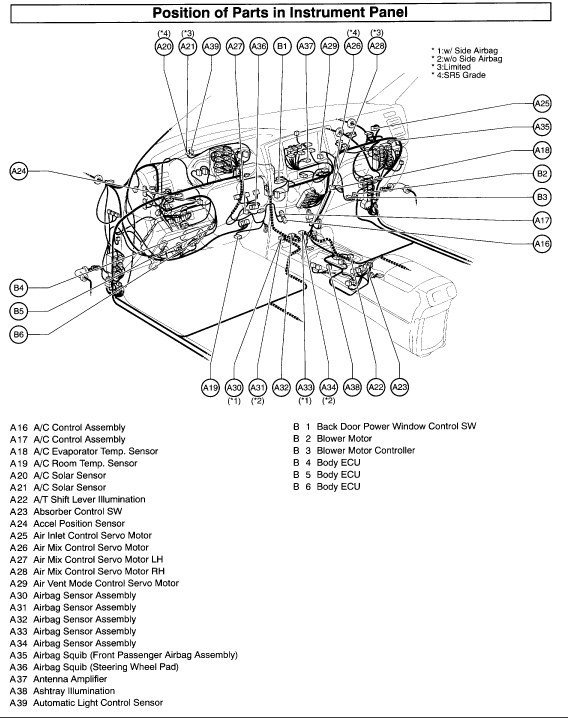

For me, the sound is coming from the passenger side, right behind the blower fan. According to the attached diagram. It looks like I might have a bad Air Inlet control Servo motor. Which would make sense because when I turn on the window defroster, the sound would stop and also when I turn off the air recirculation the sound will also stop
