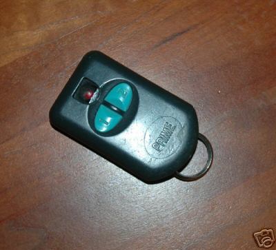

My remote says Prime at the bottom of It and their Is a number 1 and number 2 In light blue, the led is red.
Does anyone know what clifford alarm goes with this remote?

This is a picture of my remote. Please anyone!!!!
