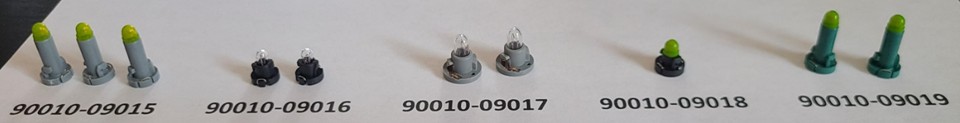

2007 T4R Climate Control Backlights - Specifics?
I am attempting to specifically identify LED replacements for the OEM incandescent bulbs in the climate control panel in a 2007 Toyota 4Runner SR5. Attached photo reflects those OEM bulbs and bulb numbers.
I've seen in other posts that the Samsung 5630(t4); 5630(t3); and 5628(t3) bulbs will work but details are lacking on specific sources and specifically which of these bulbs replace which of the OEM incandescent bulbs.
Also, when trying to identify LEDs, I don't see addressed anywhere the varying height/length of the bulbs.
Finally, I have scoured internet sources and the 5628 is not to be found anywhere. Can someone identify where the 5628 can be purchased? Or is this supposed to be 3528 instead?
In summary, I just need very specific LED identities (item or part #) and sources for each of the bulbs in the climate control panel:
90010-09015
90010-09016
90010-09017
90010-09018
90010-09019
Can someone assist with this detail? Much thanks!
