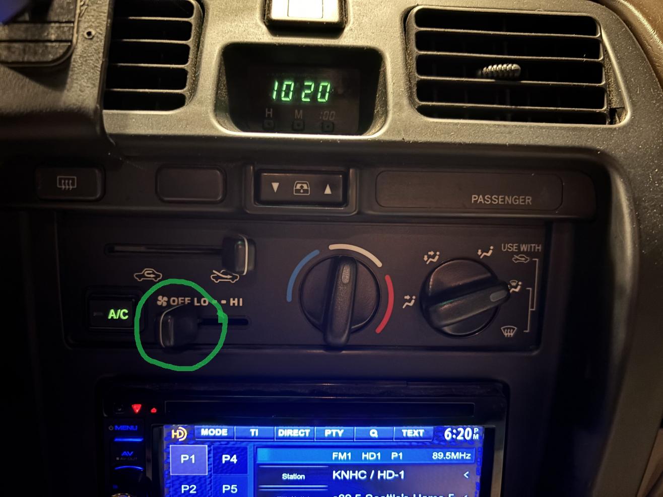

Does anyone know how to replace the climate control fan switch and what the part number is? It doesn't work when in the "LO" position but otherwise works fine in the other speeds.
Also while I am back there, what are the bulb types to bring light back to the climate control area and rear window button? I remember it used to light up green like the A/C button does right now.

I'd be thinking resistor before switch, unless low works intermittently when you fidget with the switch. The fan low speed works by running the current through a resistor to cut the current. Because that makes heat, they have it sitting in the fan's airflow to keep it cool. It's between the fan and the bland box in the passenger footwell.
Toyota doesn't seem to list the switch separately, just the whole HVAC control panel for $105: Just a moment...
Part number 55910-35121
What I'd do is use a multimeter at the resistor to see if it's getting current with the switch on lo, and then look at either replacing the resistor or switch.
Resistor: Just a moment...
Part number 87138-35050
I'd tend to just look in a pick and pull yard for parts like that, but it's nice that Toyota still sells new ones if you want to go that route.

Amazed that you could tell I drive a manual just from looking at the picture I posted.
