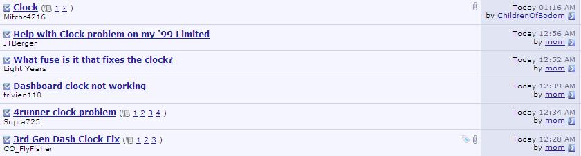

http://www.toyota-4runner.org/annou...-statement/5809-rules-toyota-4runner-org.html
GatorGreg said:
8. No multiple postings
So that our members benefit from continuity in the discussions on this board, posting the same/similar thread in multipe sub-forums is prohibited.
9. No post whoring
If you're one of those guys with too much time on your hands and you don't have anything better to do than post up every two minutes making pointless threads or just letting us know what's on your mind at that very second, then this forum is not for you. Determinations on the issue of post whoring shall be in the sole and absolute discretion of the admins / mods.
all i'm gonna say
