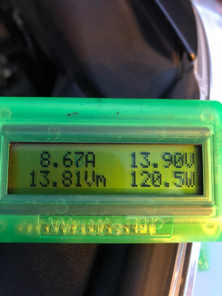

Just tested the single row 40” and I my test concurred with [MENTION=156753]rayofsi[/MENTION]. I measured 120.5W and 8.7A connected directly to the battery. That’s 40% below the advertised 200W and 14A.
Could the numbers be off because these lights are rated for 9-36V and we’re tested at the highest voltage???
Still happy with the lights for what I paid. Visually it’s bright enough and I can’t look directly into the beam.

numbers are not off.. regardless of voltage input, the regulator inside will adjust the amps pulled to still equal 120w.
My biggest question to Aurora was.. why does the 20" bar pull 80w, while the 40" with twice the amount of leds, only pulls 120W instead of 160w.
They skipped over that question of mine. Their excuse was newer leds being used. so they need less power.. Which is a bs excuse. Every other company that uses newer more efficient leds, still keeps the power rating, but ups the lumen rating.
