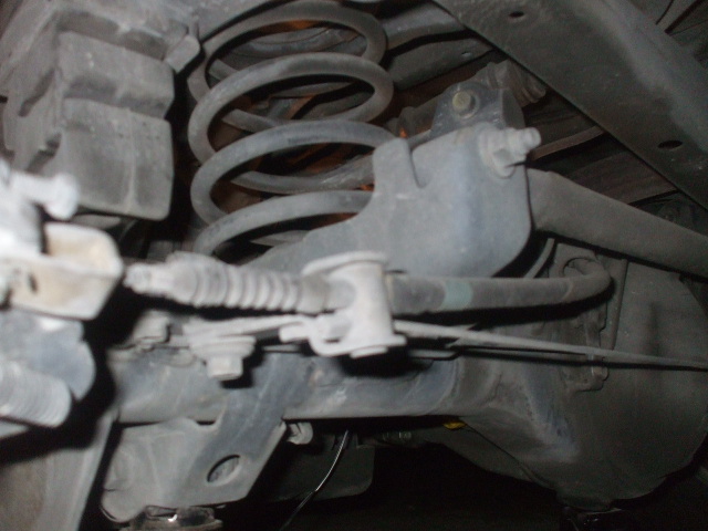

3rd Gen Runners have a recall on its rear suspension. have you had that checked out? take a picture of your rear suspension (both sides) and post it up here.

I finally got around to taking the photos and uploading it. i hope this helps in solving my problem:
0628091825-00.jpg~original
0628091825-01.jpg~original
0628091825-02.jpg~original
0628091825-03.jpg~original
0628091826-00.jpg~original
0628091826-01.jpg~original
0628091826-02.jpg~original
0628091826-03.jpg~original

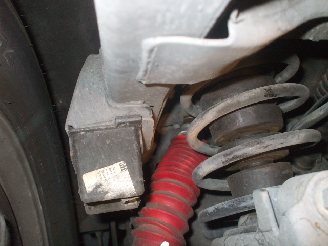

it doesnt look like you have had yours done yet. have you called the dealer? here's some pictures of mine without the new bump stops.
without new bump stops
okay i'm back with some new pictures. notice that all bump stops are new (differently shaped too).
take a look at the cone-like shaped bump stop in the middle of the coil spring itself (picture of the driver rear).
with new bumpstops :
The recall was regarding bumper stops?
I got this 4runner used. So can I just call up a nearby Toyota dealer and get the bumper stops installed?
bmperstops.jpg~original
Are you talking about the bumper stops in green or in blue?
Edit: Okay, now I see you are referring to both.
yes the bump stops that you circled are correct. they install new bump stops.
