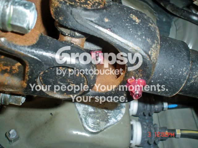

Are you sure you hit all six grease points, three on each driveshaft?(assuming you have a 4x4) I would say go give it another round in each now that the first batch worked its way in. I stole this photo from elsewhere on the site. There is a zerk at each end tucked into the u-joint, and then one "outer" zerk to lube the expansion splines. From what I understand it's the expansion zerk that gets noisy.

Alright I'll give grease another shot. The u joints I squirted until I saw some leak it, so I know they are full. The other two, I put a lot in and never saw the d's move. It's possible those two need more.
