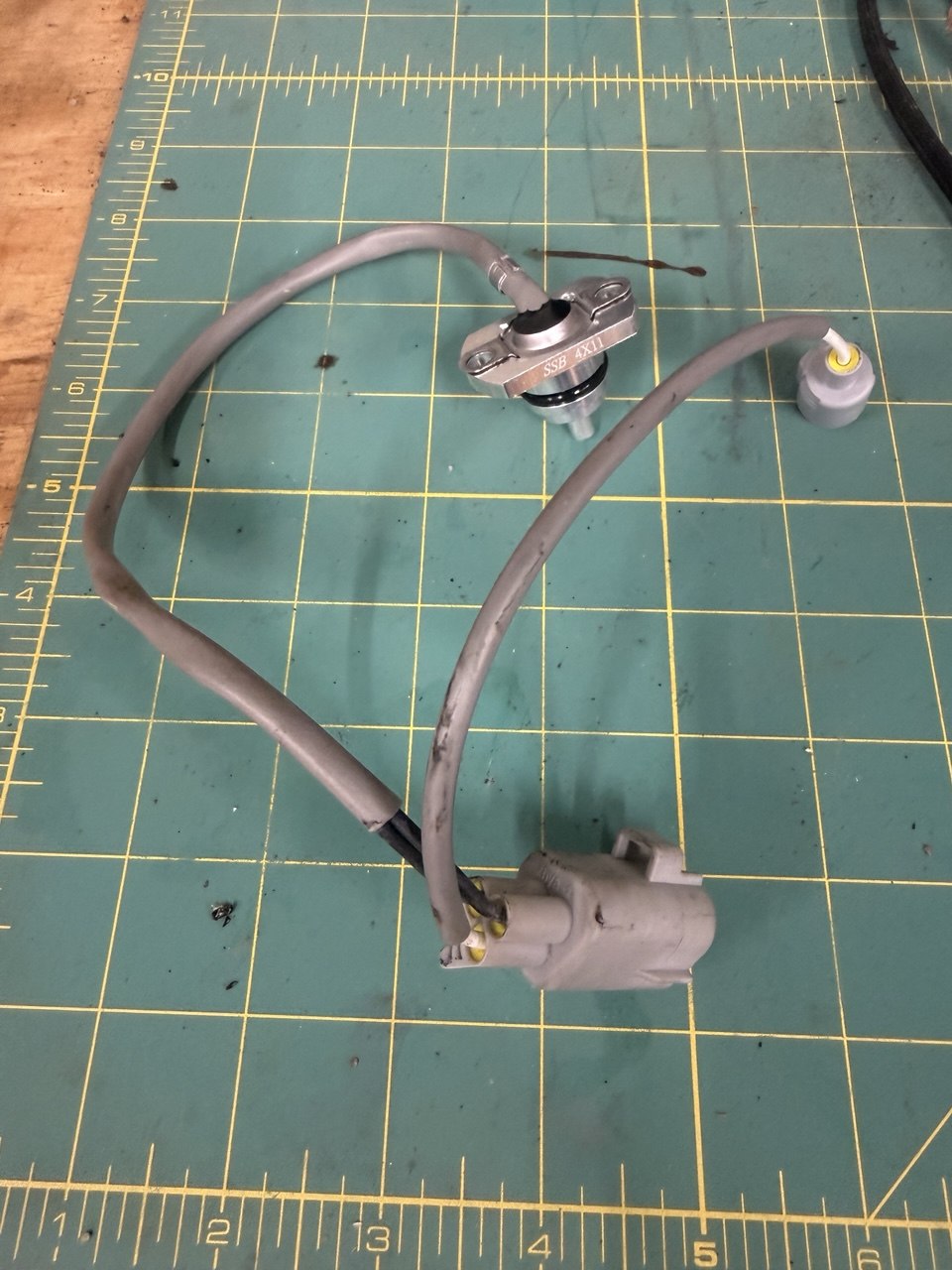

BTW op if you decide you want to try swapping the lock sensor I have a spare you can have for the cost of shipping.
