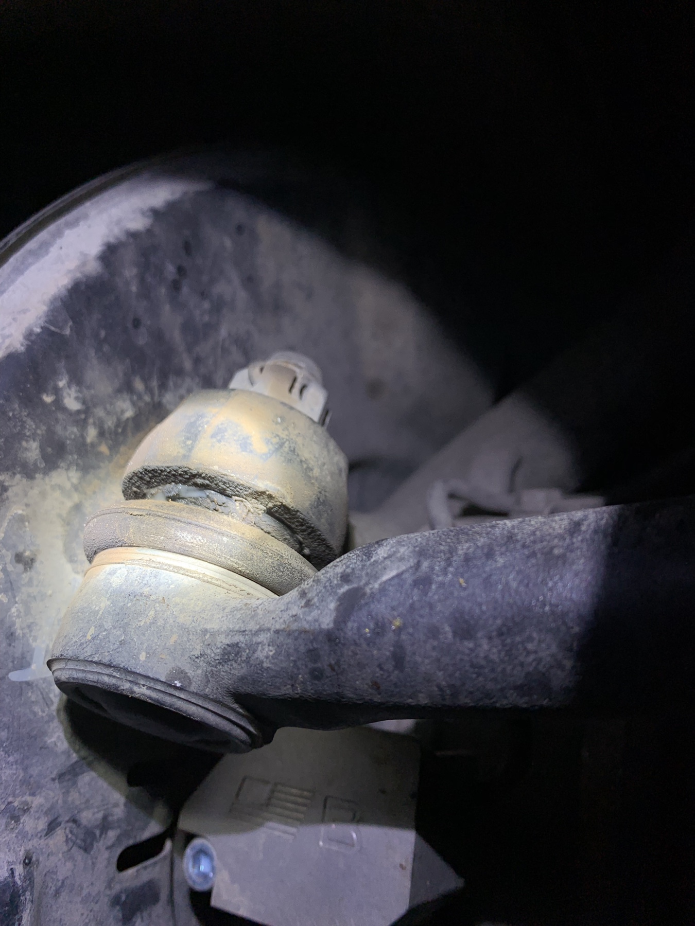

I do see some grease leaking from that outer tie rod, maybe that somehow causing it? I plan to replace it.

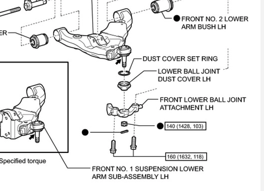

Put the front up in the air and grab each wheel and wiggle it. It sounds like maybe one of the two bolts that holds the lower control arm to the ball joint may be loose since it happens when you move the wheel.
See the bottom two bolts in the figure, torque them to 120 *118 if you want to be fancy and precise. Those maybe your culprit.
