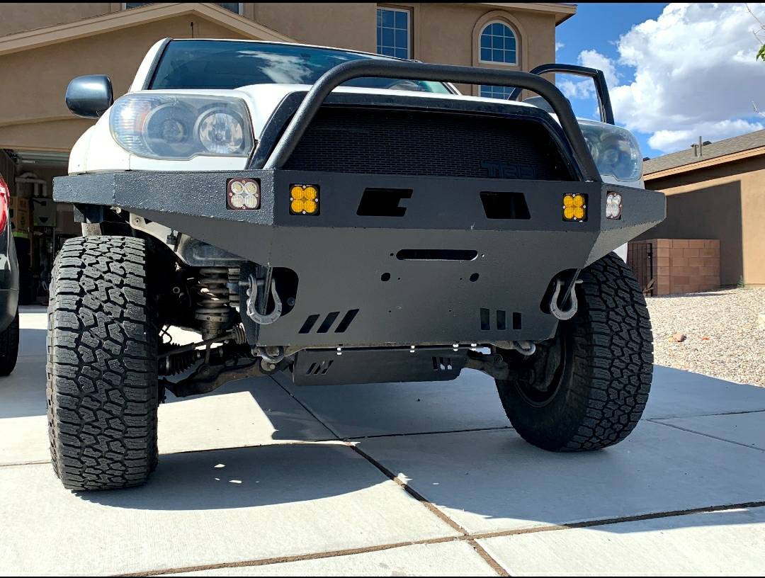

Sexiest bumper on the market pho sho
PS got a friend who welded it for me

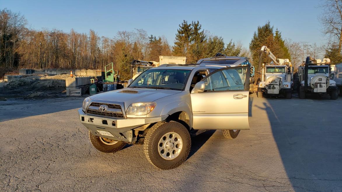

The fit up is pretty good, some minimal grinding required for everything to fit great. I had some issues but for first time welder with zero experience and no classes or anything, I think mine turned out well. Having issues uploading photos for some reason or I would add one.

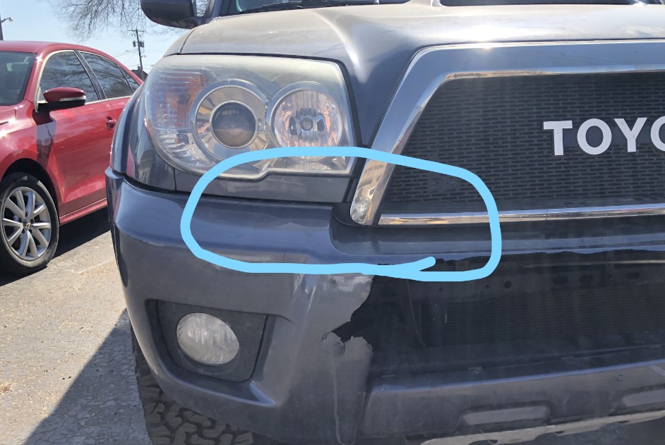

I have the 06' 4runner and my grill looks like this (Mind the current bumper - had a mishap the other day).. Is this the "smile" you're referring to?
No. The smile is the line from the grill to the fender. It goes up slightly. Hard to see in pics but when you are building the bumper, it becomes very obvious.

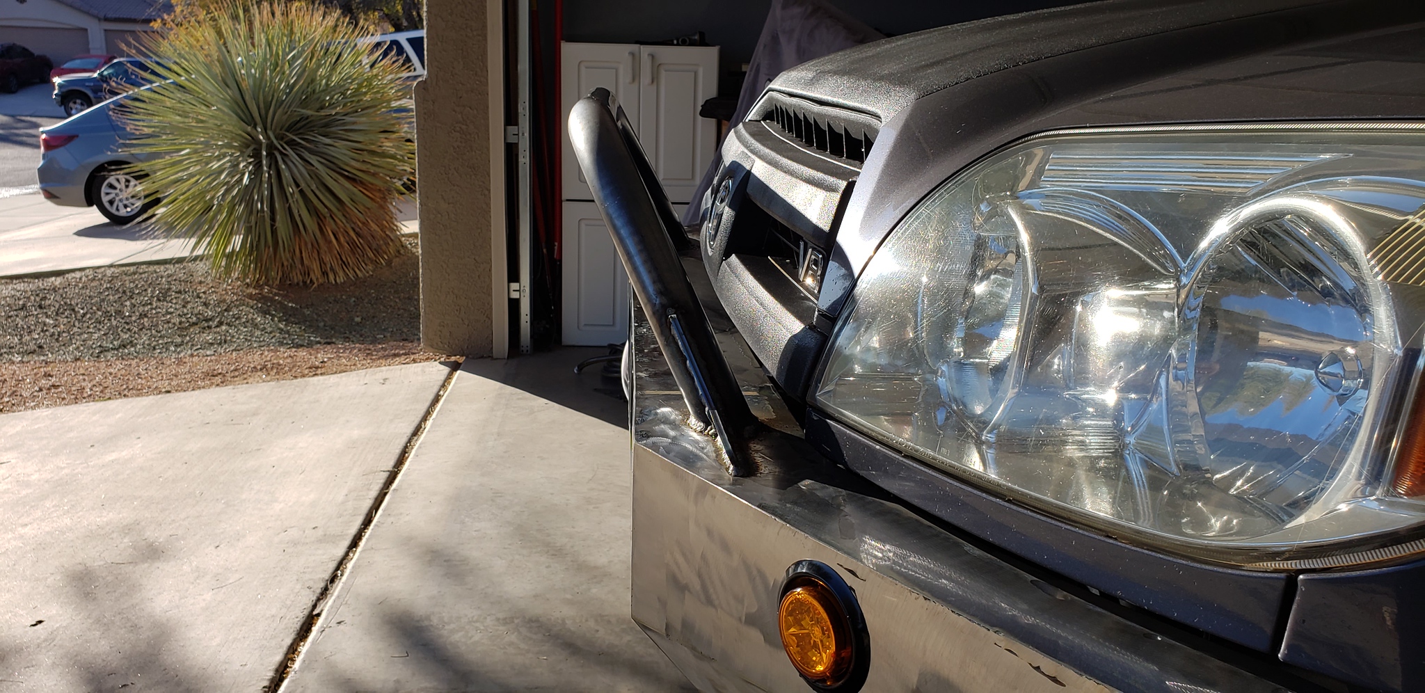

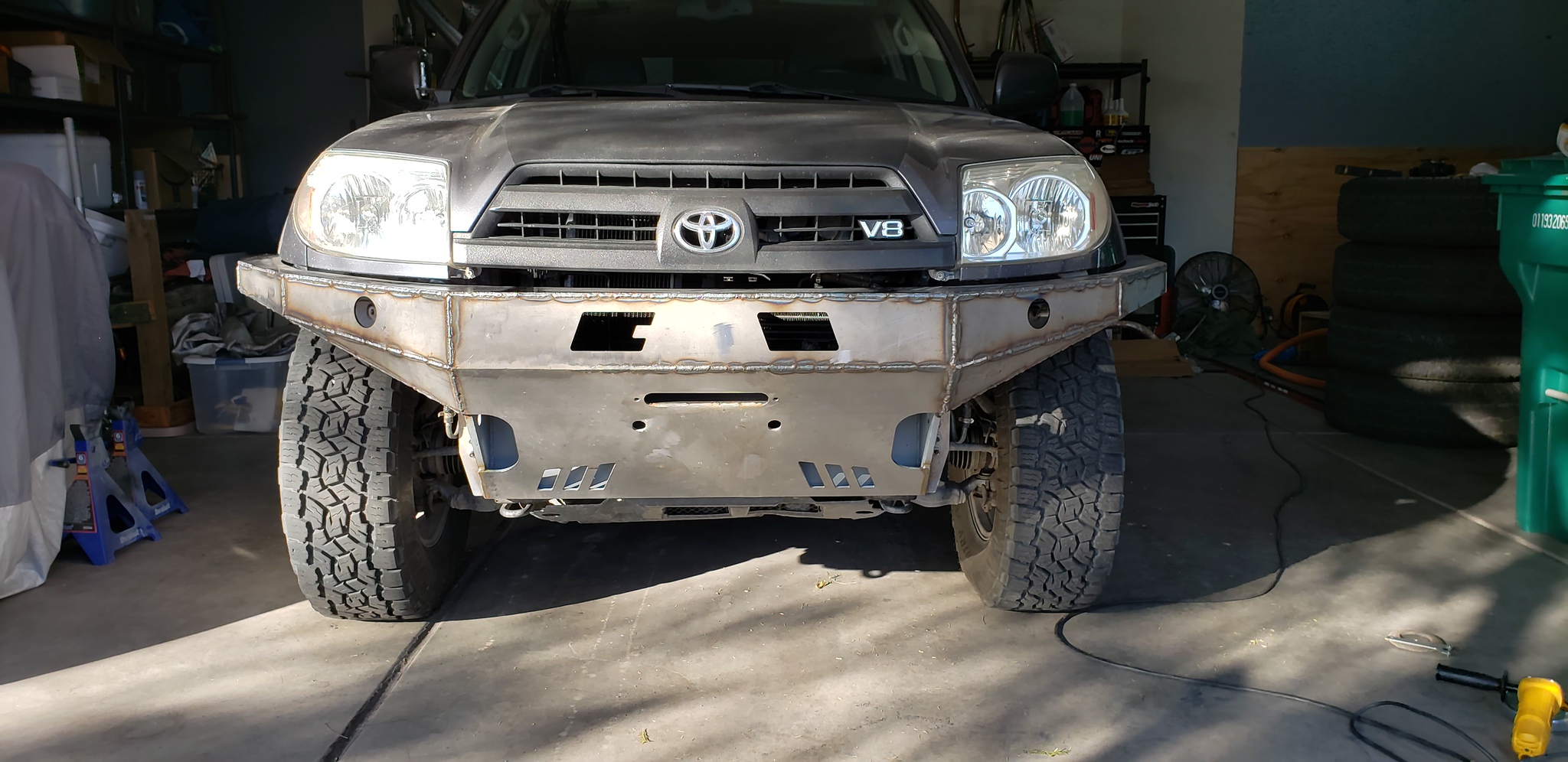

The 06+ grill won't be an issue either. The bumper sits low enough to compensate for the lower hanging grill. You can also modify anything on the bumper while you are building it. You HAVE to build it on the truck, only the finish welding is done off the truck. If you do all the building off the truck, the bumper will not fit or look right.
The top plate that I have the hoop welded to is the area of your concern. You can see there is a good gap there that your 06 grill will be able to drop into and clear the bumper just fine.
Also note that you need to specify your model year when placing the order. So Coastal DOES address this difference in grills.
