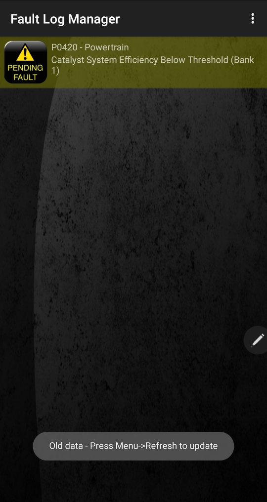

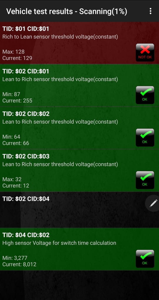

Hi.. I have a 2002 toyota 4runner 2WD DRIVE socal car and its up for smog test.. The code 420 comes and goes occasionally last 3 yrs.. Had a code420 come up this 2 months .. So I did a reset and been running on 91 octane last 3 tank fill up.. So far,, its only giving a pending fault code420.. no check light but barely failing ## emission number in torque app.. Max is 128..measures 129.. Fail... But no check engine light,, only pending 420 on torque app..
Can i take it like this to test and will it PASS??

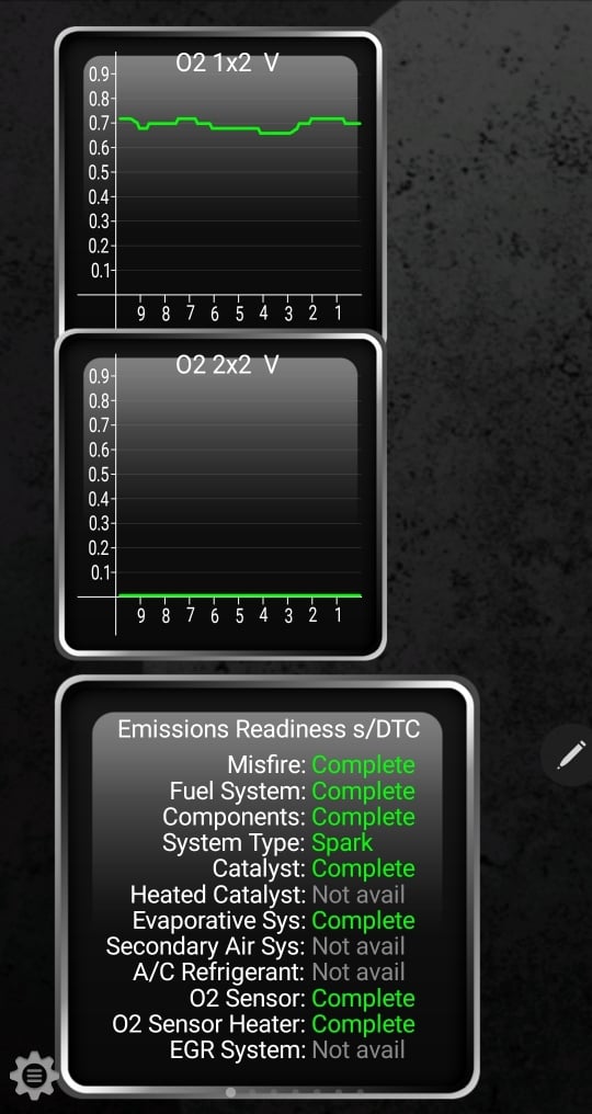

At idle---------O2 reading wave form is steady.

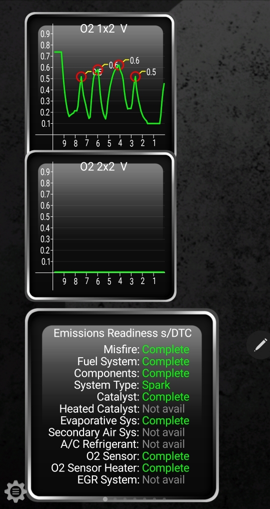

At 2500rpm.. O2 reading is full rapid sine waves which is failing..

I will see if I can post he torque app ### on the catalytic converter max and measured values...
