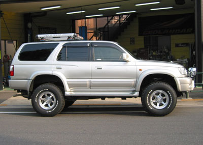

The Tacoma (95-04) one will fit the 3rd gen 4runner. They only do the front, so you have to figure out something on the rear. I had the Tundra Valved ones with an ARB Bull bar, it rode great. I had these on my Tacoma. I sold them to a guy in colorado that installed them on a 4runner. I loved them. here is photo

Manu G, I have a 3rd gen 4runner w/ the Sway A Way coilovers in the front and the OME 881 springs in the back. By the way, Sway A Way coilovers are also called SAW's.
You can buy them from performanceproducts or you can search for them from most 4x4 shops on the internet. Here's a few pictures of my truck:
