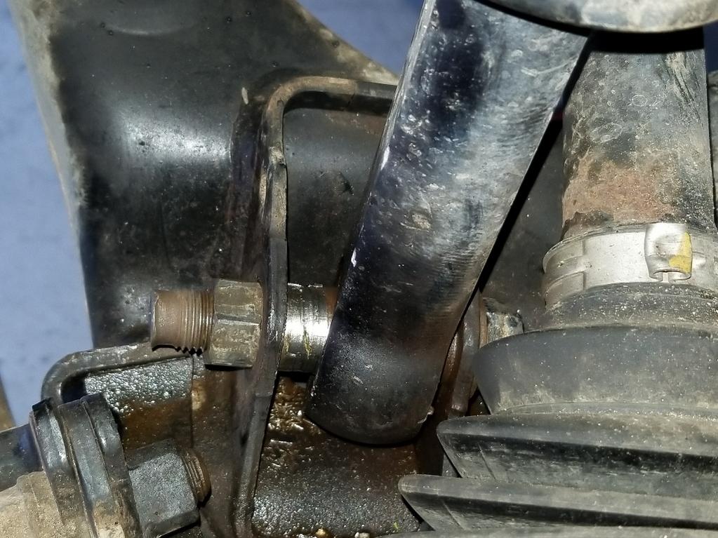

Well... time to replace the spherical bearings in my front coilovers (fox). They're noisy as hell. I thought it would be a 1-2hr job. Not so easy. The misalignment spacers are damn near fused onto the lower control arm bolt. Any tips or tricks to getting it to let go?
So far I tried using a BFH until it was mushrooming the end of my drift (a rod of 3/4" solid round bar) and ruining the end of the bolt. And I tried heating it until smoke was coming from the teflon of the joint - I didn't want to go much hotter and risk a damaging the shock its self. I've tried pb blaster. That's kinda all I got.
Next step is to use an angle grinder and cut off the bolt on both sides of the shock and just throw away all the parts.
It's shiny because I tried to use a vice grip on the spacer in hopes I could break it free by turning the bolt with a wrench - it just shaved a bit of the aluminum off.

If I have to cut it out - it probably makes more sense to cut the control arm apart. And if I have to cut the control arm apart, no sense in replacing with another one that's just going to go bad again right? So I think the only logical conclusion is to replace with a long travel suspension right? It's either that or two $4.57 bolts and $30 in misalignment spacers. I don't want to pay $4.57 a piece for bolts. I'd be wasting money.
after the heat the spherical bearings are 100% toast
Where's the washer under the nut?!
Is it possible to cut the mushroomed portion of the bolt flush with the nut, and use a nutsplitter? It's a tight spot
*edit
now I see, you had the nut off but the misalignment spacers wouldn't let go....
That sucks JB. My recommendation above is no help at all. Sorry dude
Yeah -I just put the nut back on temporarily and happened to be tightened up in the pic. The bearings are definitely toast. I had to put it back together temporarily for a week until I can pull it apart again. I can get the bolt from the dealer - but the spacers I have to order and wait till they arrive.

Are you able to buy stainless misalignment spacers for the next round? GD aluminium turned that bolt in to a battery

Not sure about how much room you have... Tack weld the nut in place. Then go loosen from the bolt from other side. Worth a try... Then grind off the tacks... This will save you a few $$s vs the LT LCAs.
BTW, does the bolt spin? Make sure all the tension is off. If I remember correctly, KDSS will put tension on it...
Yeah, the bolt will spin along with the spacers. I removed the top plate so it was totally loose. I can't believe how bonded it is. They've only been in there for about 2 years. Definitely going to get a good coating of grease or something next time.
Anti seize for sure... I messed with one friends truck that had been down at the beach a bunch and it was a nightmare getting that bolt out. Covered it all with ani seize and a year or two later we swapped the suspension and it was easy like my truck....
Had the same thing happen as well, and I tried everything you did too. What finally worked for me was a penetrant (liquid wrench or whatever) and let it sit overnight. Eventually I was able to separate the bolt from the spacers.
The experience really reinforced the need to use a good anti-seize on EVERYTHING that doesn't specifically call for loctite
I soaked in a penetrating oil and I'll give it a shot again tomorrow night. Can't do it tonight.
If not Accutune has a set of spacers in stainless instead of aluminum. $40 shipped for the set.
Pull the nut off and use cut off wheel to flush cut the end and head of bolt off. ( probably LBJ removal for access )
Then slightly bend "ears" of LCA to remove shock .. FPITA!
