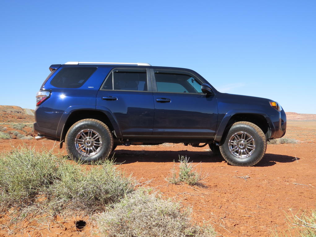

This morning I finished the lift project by installing CoilRite bags and a pair of OME shims on each side. The effect is amazing, and I ride almost level now (1/4" tail high). I plan to use the bags for the left-side lean, and for towing my 3500# popup camper.

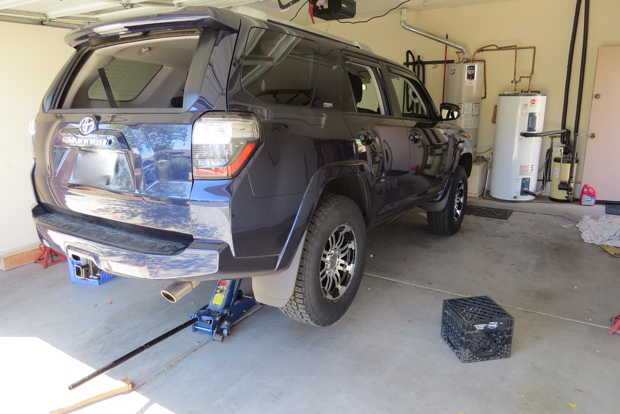

Okay, here we go. The CoilRite instructions are the typical Google Translate Chinese to English that we've all become used to. I recommend using air tools if you have them. I also found the new ratcheting box wrenches to be helpful. You'll need to borrow a spring compressor from the local auto parts store.
Remove the spare tire following the instructions in the owners manual. You'll notice in the pics that I did not do this initially. It was a mistake. I needed to remove it to ease the run of the air lines to the rear. Chock your front wheels and place your floor jack under the center of the rear axle. Raise the rear end about 8"-12".

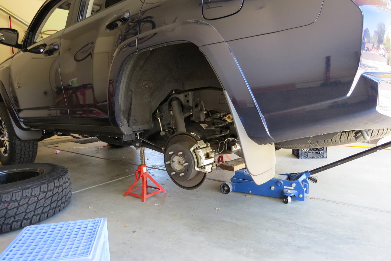

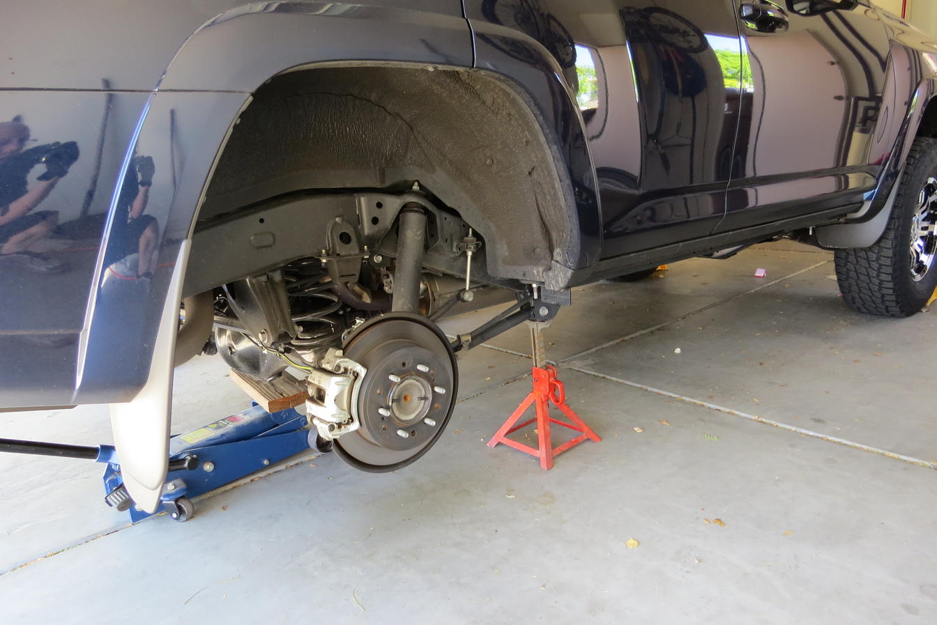

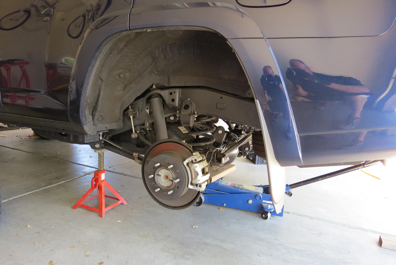

Use suitable jack stands to support the vehicle forward of the axle. Remove the rear wheels.

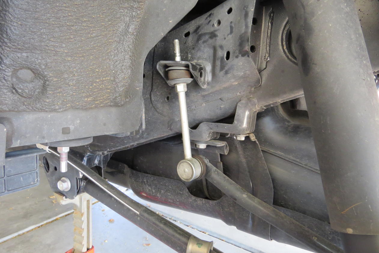

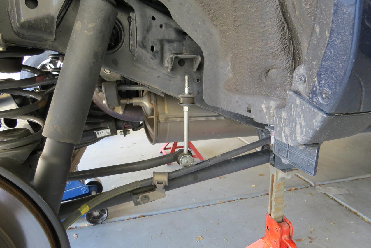

Detach the sway bar from the frame on each side, and allow to hang freely.

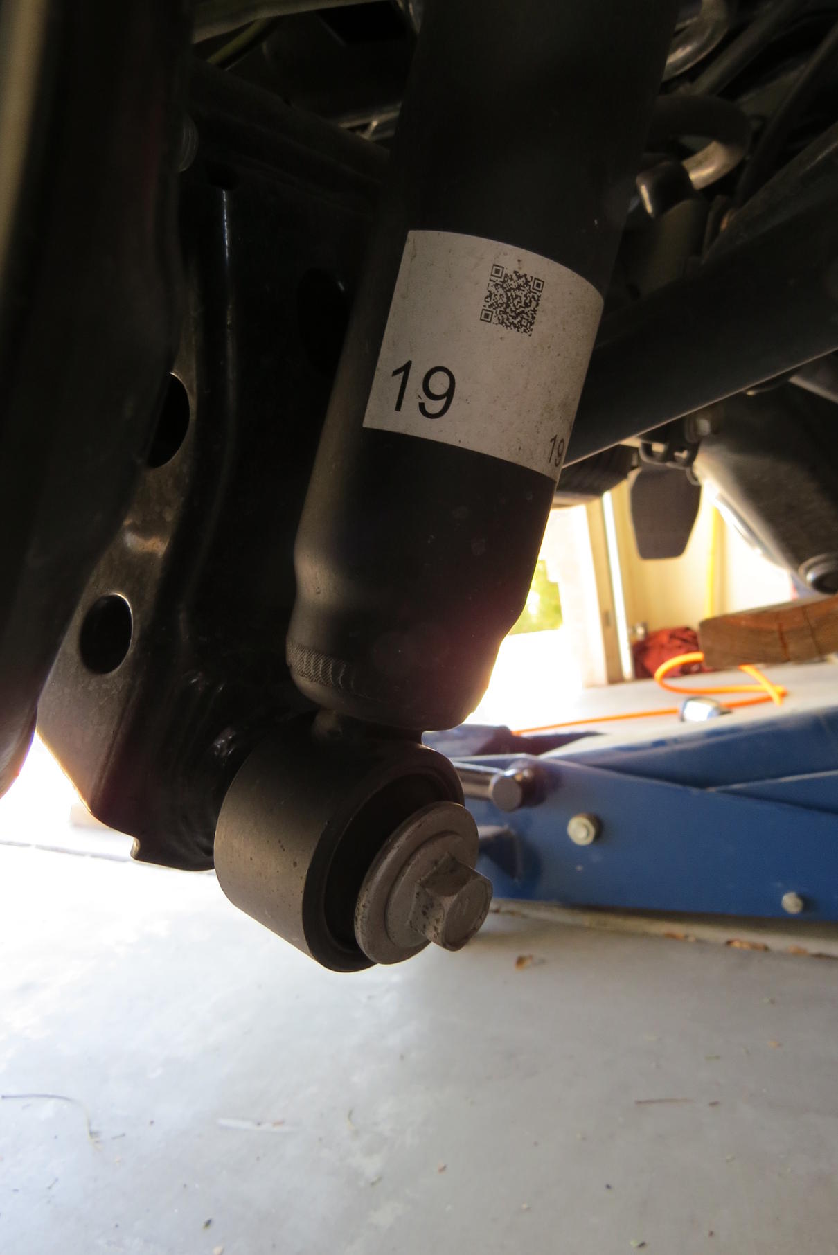

Remove the lower attachment bolt for each shock absorber, and remove from the lower mount, to hang freely.
Remove the driver's side bolt for the panhard rod. It's the straight rod, just rear and above the axle. It mounts a little higher on the passenger side. Once the bolt is removed, carefully lift the bar away from the axle and allow to hang freely. !!! Watchout for the brake lines here !!!

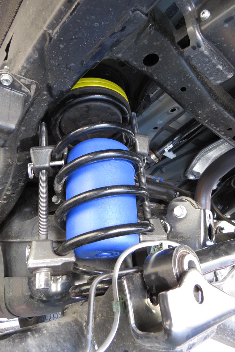

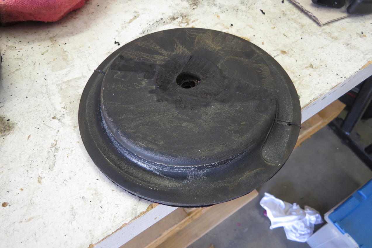

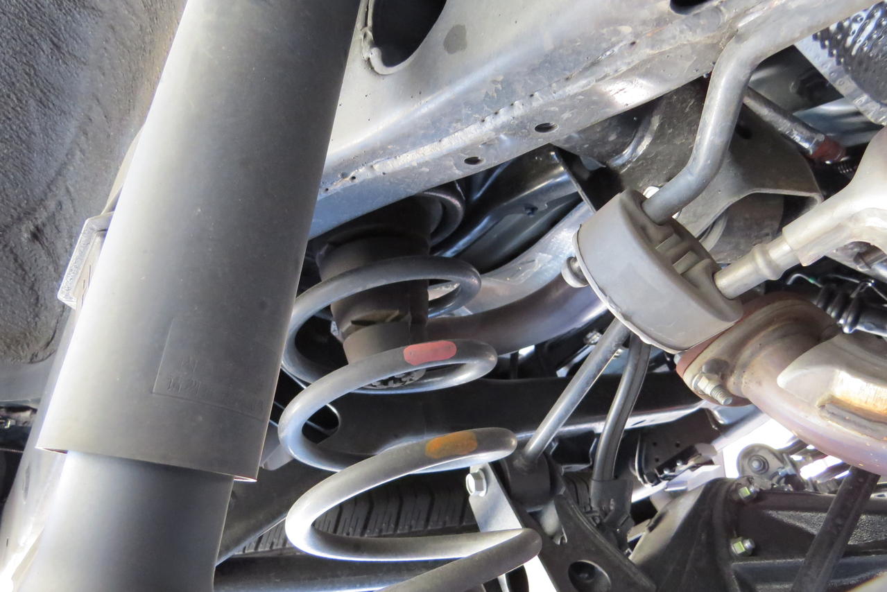

Here's a shot of what we are after - the coil spring and overload bumper.
Now use the floor jack to lift the axle a few inches. Place a jack stand under the passenger side of the axle, as far right as practical. Lower that floor jack. The objective is to lower the driver side enough to easily remove the coil spring and overload bumper. It took me a light tugs and twists, using a large slot screwdriver for some leverage.

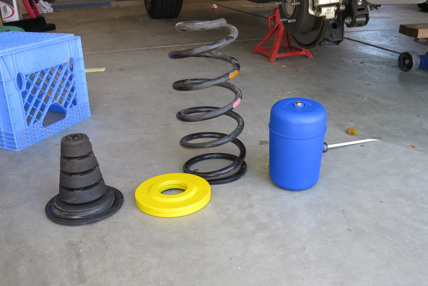

Here's a pic of what we will be assembling...
Here's the part where we take a big gulp. The overload bumper needs to be significantly modified. Remove the bottom 4 sections with a hacksaw, and use a rotary tool to smooth it out. I am not making this up.
Attach a spring compressor to the coil spring, and compress the spring to a point sufficient to insert the modified bumper and the shim(s). This takes a little trial and error. Once I had the compressor positioned well (arms roughly opposite, at locations that do not interfere too much with coil install position), and the spring compressed enough, I placed the airbag in the coil, feeder side up. I placed the coil in position. Then, one at a time, I slipped the bumper and the shims above the spring. I evenly backed off the compressor and removed in from the coils. There is still enough play to wiggle things to alignment, even with two shims installed.

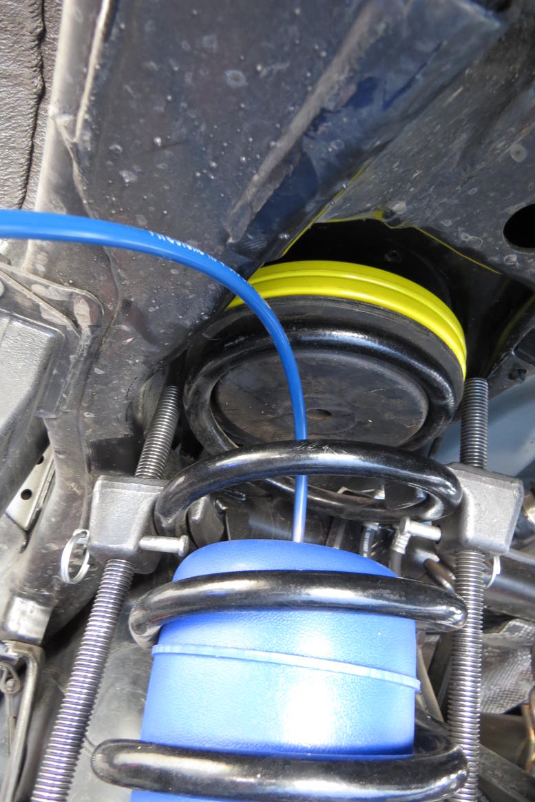

Cut the provided hose into two sections of equal length. Use a sharp blade for a clean straight cut. DO NOT use wire cutters/dikes to cut the line. This will interfere with the press-to-connect fittings at the bag and valve. From the side of the coil, firmly press one end of the line into the connector of the bag.
Then snake the other end of the line thru the holes in the bumper and shims. It's then a matter of patience and creativity to work the line to the rear, locating a suitable install location for the valves.
Raise the axle again and move the jack stand from the passenger side of the axle to the driver side. Repeat the instructions for the passenger side. The kit from Firestone includes heat sheilding for the air line. USE IT!!!
Here is a shot of my valve positioning...

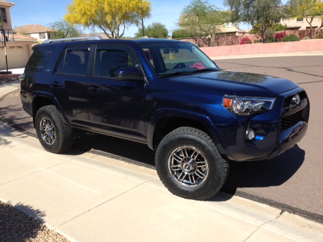

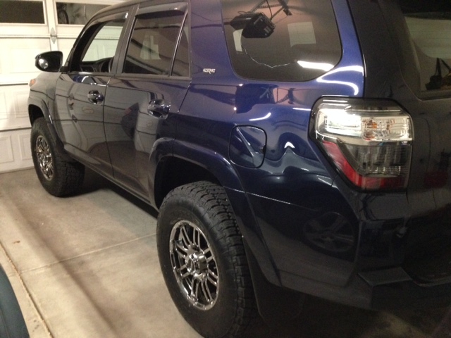

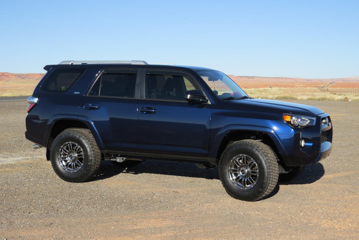

Some pics with the new rims
I got the 0mm offset rims installed today. I tried not to squeal like a girlie when I saw them. I didn't think they would look as good as what I installed originally, but they a way way better.
I took a couple pics with my iPhone 5C - I'll try to take some real pics during the road trip next week.
Let me know what you think, or if you have any questions.

Please let me know what you think

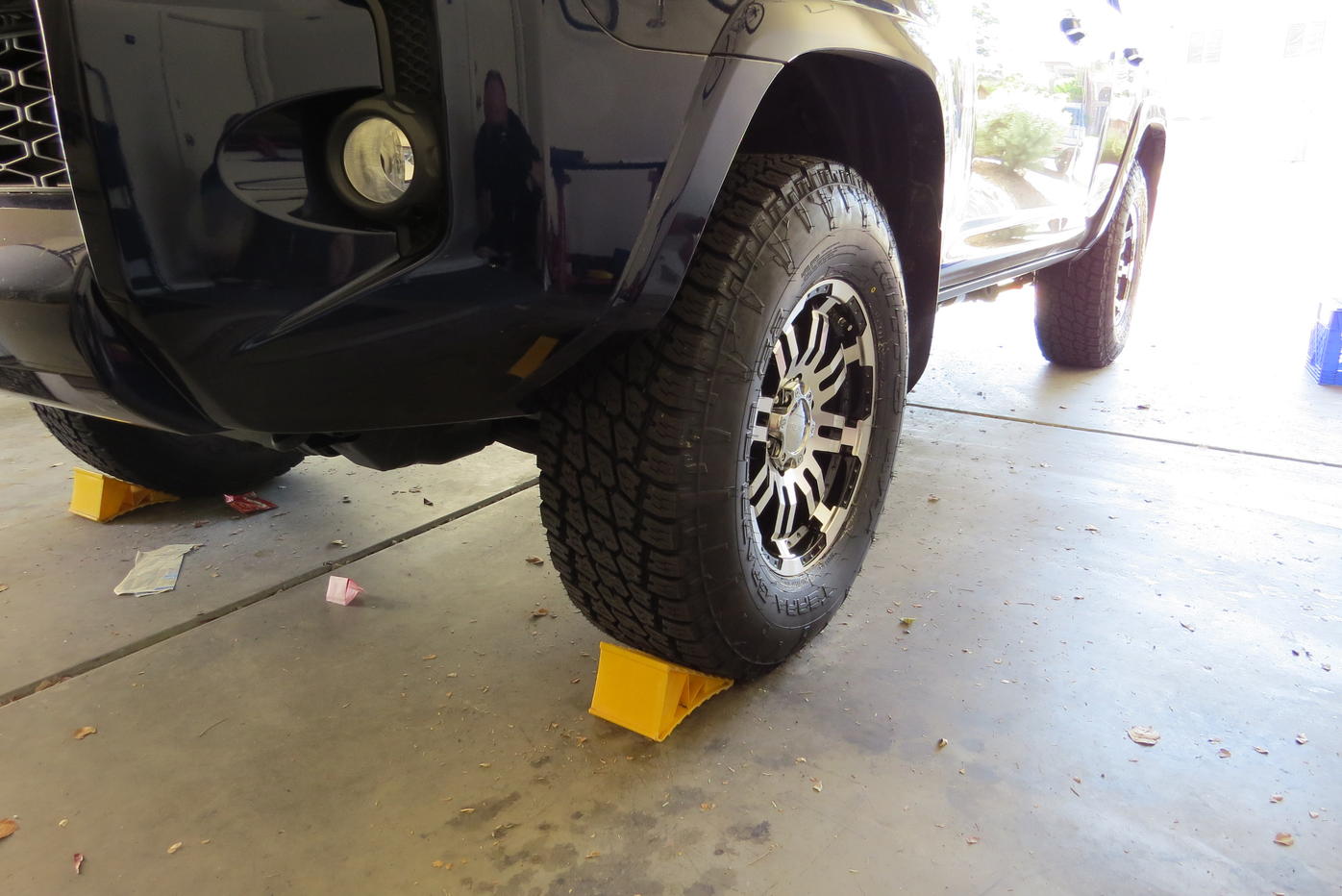

I have now replaced the 25mm offset wheels with 0mm offset. The new wheels are AR901's, with the PVD finish (came out like "black chrome").
I couldn't be happier with the look. My acceleration took a hit, but the gas mileage doesn't seem to be a huge difference. Any advice on performance mods?
There was some rubbing up front, and a little plastic surgery did the trick.
It rubs a bit every now and then, but just to remind me that I went big enough.
Looks good! I don't normally like chrome, but you pulled it off nicely!
