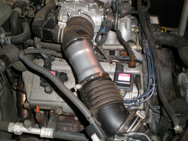

The next biggest diff is make a cheap intake pipe to smooth the incoming air out which I've seen effectively done with a bug spray can and some paint.

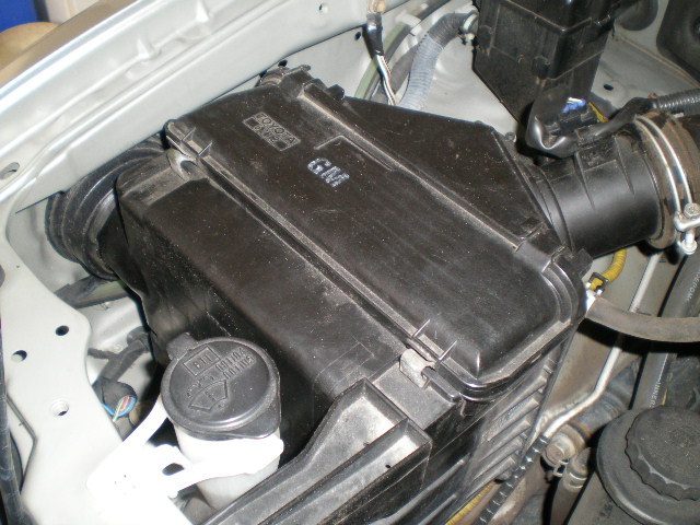

Here's another thread where you can learn more about the deckplate, elbow removal, and ISR mods If you're concerned about ruining your stock airbox you can do what I did and simply remove the elbow from the passenger side inner fender well, and make an attachment that bridges the gap between your airbox and the circular opening. I like this setup better than the deckplate because you can always put it back to stock if you choose, and along with the ISR mod I feel you get a sort of straight shot of fresh air that comes from outside of the engine bay. :my2cents:

The deckplate is so easy to do and the circle doesn't have to be perfectly cut since you're going to lay the deckplate over the hole and use some sensor safe sealer and small screws to affix it to the airbox. Adding a screen is a good idea to keep larger debris out of the airbox.
