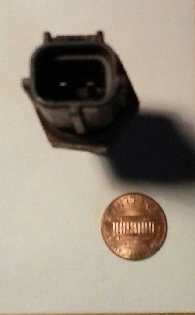

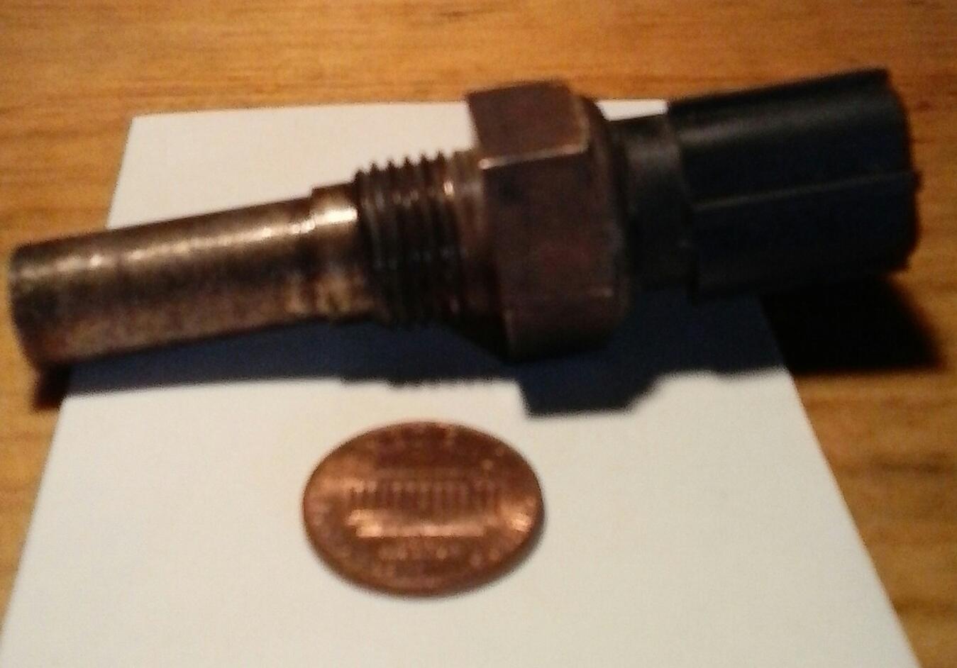

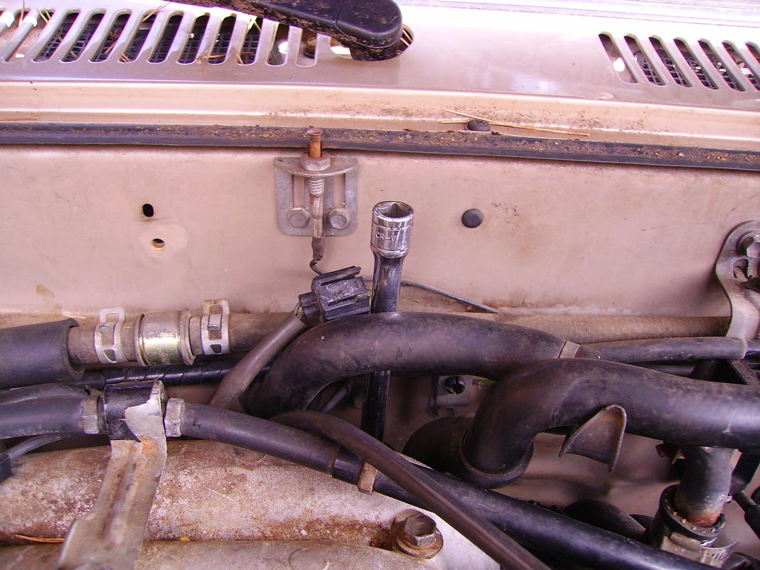

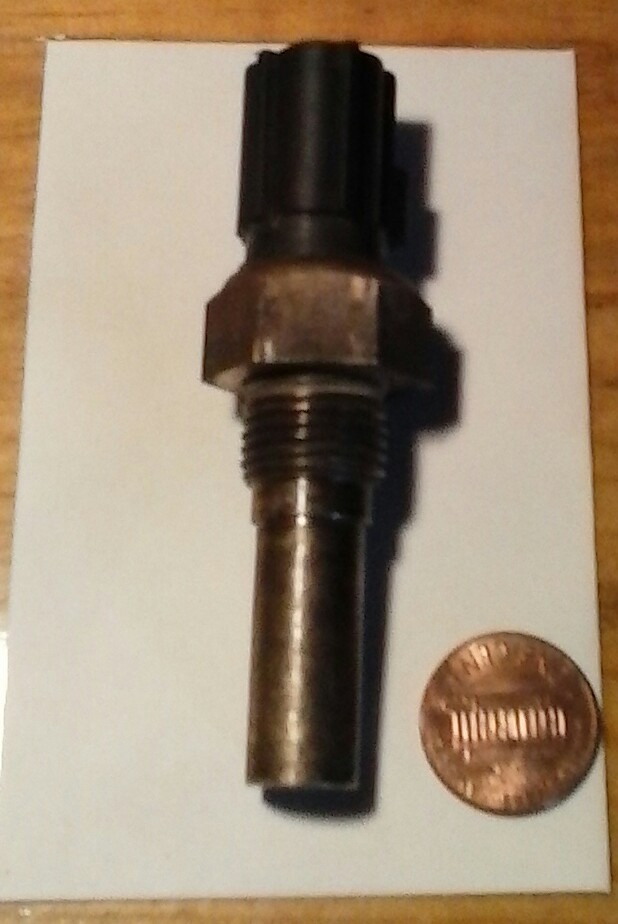

Would you be so kind as to post a picture of the location on the motor where the switch is located and if possible a picture of the switch removed? I think I have a similar problem. If you know the thread specs I may have a lower cost solution to suggest. There may be a cross over from another vehicle that would fit.
As you can see from this pic, the sensor is not visible by camera (at least not for me), hubby put tool showing where its located.

would you be so kind as to post a picture of the location on the motor where the switch is located and if possible a picture of the switch removed? I think i have a similar problem. If you know the thread specs i may have a lower cost solution to suggest. There may be a cross over from another vehicle that would fit.
